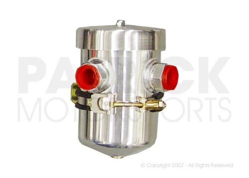

http://www.patrickmotorsports.com/part/oil-08-0400/
Mounted to right side engine compartment and has drain back into cam cover.

QUOTE(BKLA @ May 14 2013, 03:31 PM) *
Yea, that's the one I have in the garage.
