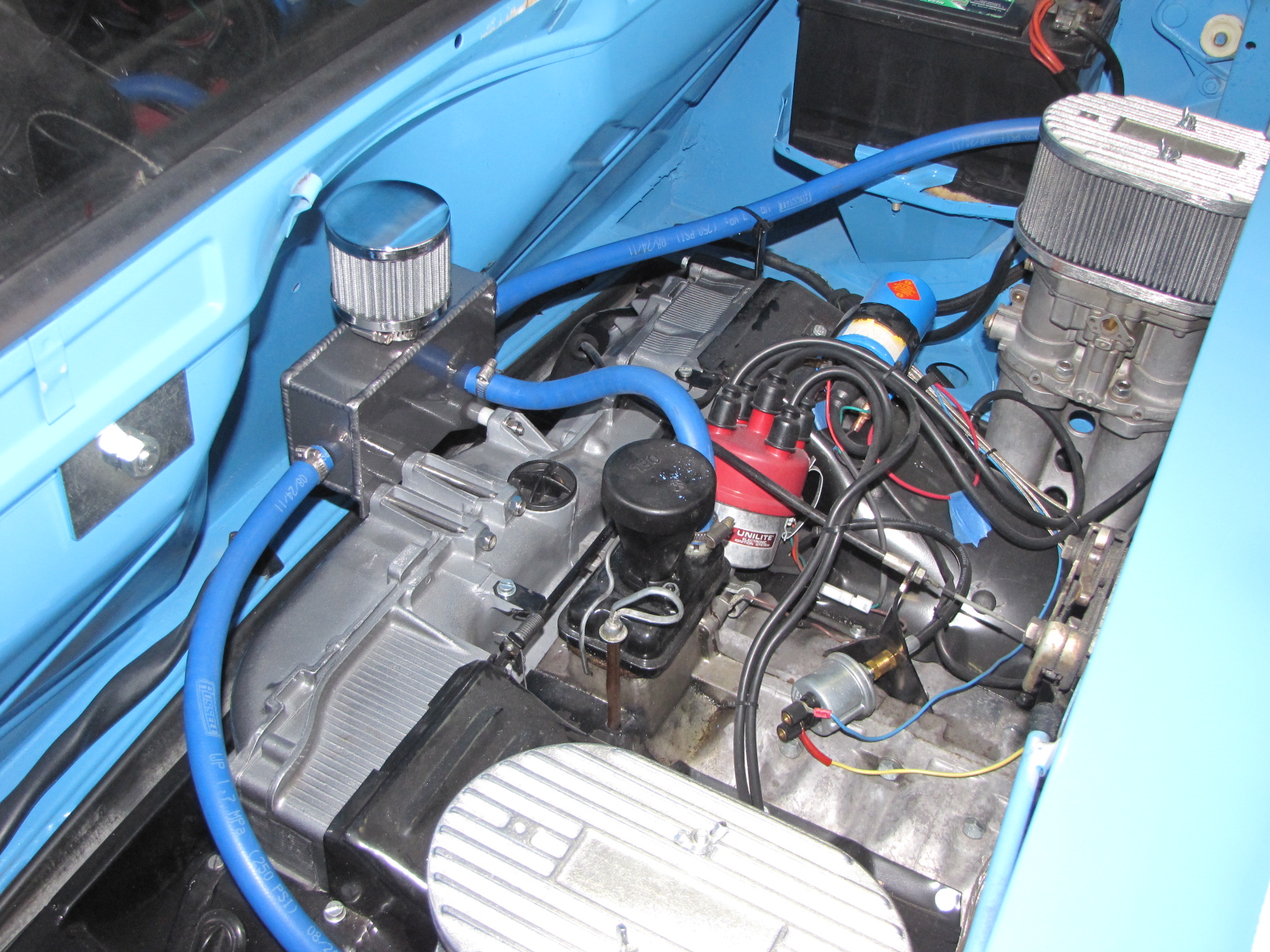

ww914
post May 23 2013, 07:21 AM
914 Convert
Posts: 435
Joined: 29-September 11
From: Central Coast, CA
Member No.: 13,621
Built this one out of 1/8" aluminum. I had the welding done.
