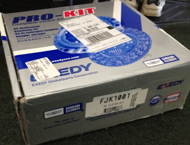

1. Be very careful to choose the right clutch kit. For example, my trans is a 2006 WRX, which supported a 2,5T. Although many sites and ebay sellers will say that the cheaper KSB03 or KSB04 clutch kit works, they DO NOT. The one you need is the FJK1001. It's $100 more but if you use the cheaper one it won't engage properly and will chew up the clutch disc...search NASIOC for cross-reference for the clutch that works with your trans.

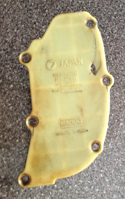

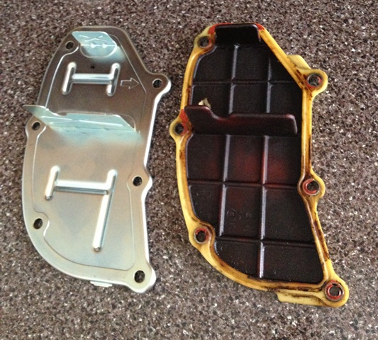

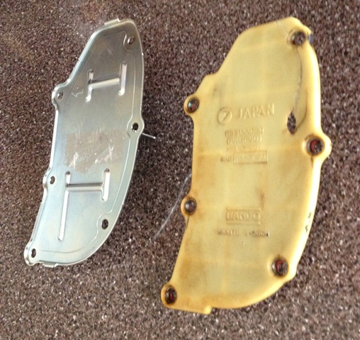

2. Apparently Subaru changed the oil separator that is under the flywheel from metal to plastic in the '90's...and it wasn't a good idea. Then they went to aluminum...still bad. Now the replacement is steel. If your engine has one made of plastic or aluminum change it. Both leak like crazy.
Good thing I poked a hole in mine trying to lock the flywheel! YEAH! Meant to do that!
Here's the old one and new one...universal and fits several models. The new part # is 11831AA210

Chris H.   Couple of notes.... 1. Be very careful to choose...   Jun 4 2013, 05:59 PM
Chris H.   Here's what the oil separator plate looks like...   Jun 4 2013, 06:12 PM
