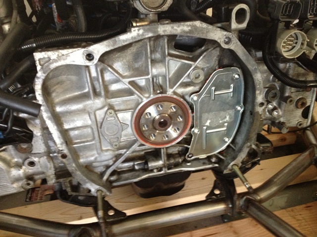

Here's what the oil separator plate looks like installed:

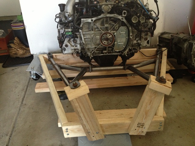

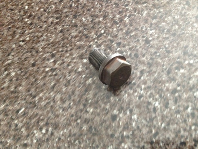

Lately it's been a game of hurry up and wait...I failed to realize that the bolts that hold the flex plate on the 3.3 are shorter than what is needed for the flywheel...now I had to order the bolts! No Subie dealer has them:

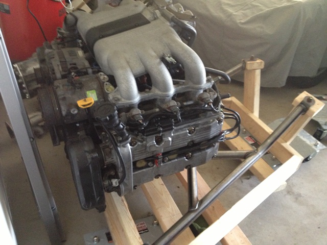

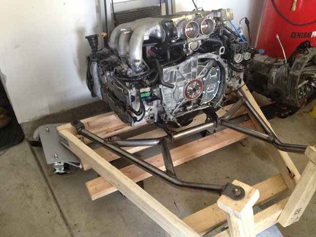

Attached the engine mount (fits great so far) and got the engine down off the stand. I made this boxed wood frame so that the weight is evenly distributed and the engine and trans will be in the positions they will be in the car. It was VERY easy. Plus it keeps the oil pan off the ground.
Once my bolts come in (and a couple of other issues come up and get resolved) we'll mount the engine to the trans and test fire it. Still have a lot of wiring work to sort through...
