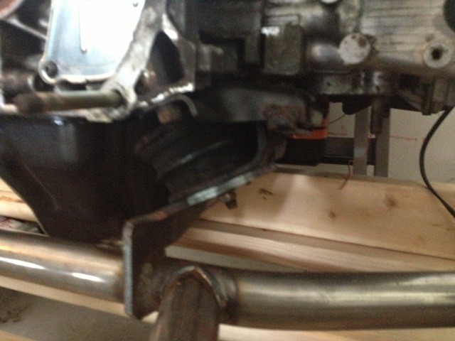

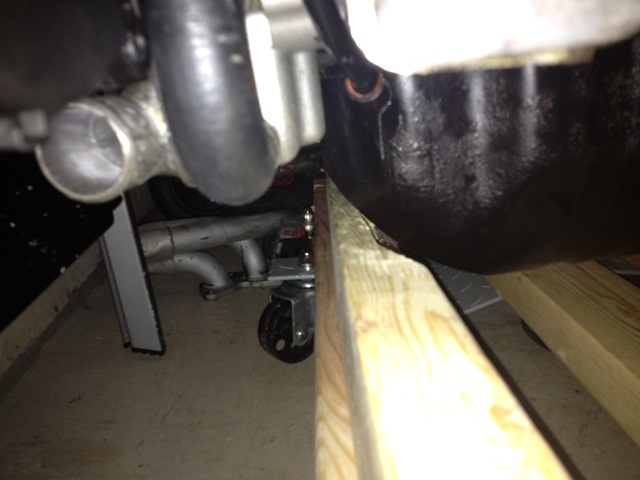

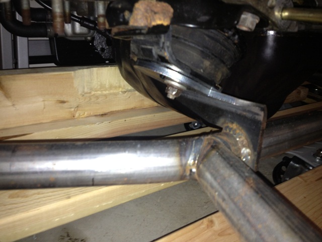

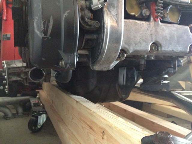

Hey Jim,
Believe it or not the engine is being held in place almost entirely by the mounts coming up from the engine bar. They are VERY strong:
Although the front wood piece does provide a small amount of support it's barely touching the pan. It does stop forward movement at some point though and I think that is critical until the trans is hooked up. We're talking 80/20 weight distribution here....
The initial idea behind the wood frame was to keep the oil pan above ground when I lowered the engine down from the stand. Then I realized it could be extended back to the trans mounts and slightly change the weight distribution so that the engine doesn't flop forward onto the floor. If it wasn't for my novice mistake of forgetting the flywheel bolts the trans would already be in and the lump would be pretty evenly weighted. I want to get it running before I put it in so that will be next. Hopefully Ian will make some cable kits so I don't have to fab my own.
