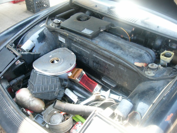

914momo   Here are some pics,there not he best shots but the...   Jul 8 2004, 05:15 PM

914momo   I take that back the interior is shot the only goo...   Jul 8 2004, 05:21 PM
morphenspectra   Looks like youre in business :trophy: look at it...   Jul 8 2004, 05:22 PM

914momo   frint trunk   Jul 8 2004, 05:28 PM
morphenspectra   if ya want i can come take a look at it?i see rust...   Jul 8 2004, 05:31 PM

914momo   Morph I hit all the rusted areas pretty hard,and i...   Jul 8 2004, 05:48 PM

bondo   Looks like repairable rust to me.. but take a clos...   Jul 8 2004, 06:24 PM
Dave Bell   $100... I paid $75 for a side shift tran...   Jul 8 2004, 06:59 PM
boxstr   Buy it and add it to your collection. CCLINTHE...   Jul 8 2004, 07:19 PM
nebreitling   it's a no brainer for $100, though the ch...   Jul 8 2004, 08:00 PM
