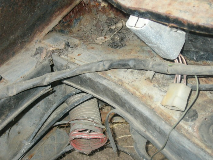

Well a few months later I found this website called 914world.com,an noticed lots of people talking about rust in the battery tray area, so I went outside and took a look at my own car....Holy F*&%in shit my car was rusted all the way through to the suspension (IMG:style_emoticons/default/headbang.gif) (IMG:style_emoticons/default/headbang.gif) .........It looks like the right trailing arm mount busted at sometime or another, because the PO (IMG:style_emoticons/default/finger.gif) welded some 1/4 in steel to hold it together....
I started to look a little farther and found rust everywhere,the longs,under pass seat,everywhere.........I guess my question is would this be worth fixing myself or would it be cheaper to buy a rust free tub? Here are some pics..............

under batt

914momo   under batt   Jul 8 2004, 05:34 PM

914momo   Morph I hit all the rusted areas pretty hard,and i...   Jul 8 2004, 05:48 PM

bondo   Looks like repairable rust to me.. but take a clos...   Jul 8 2004, 06:24 PM
