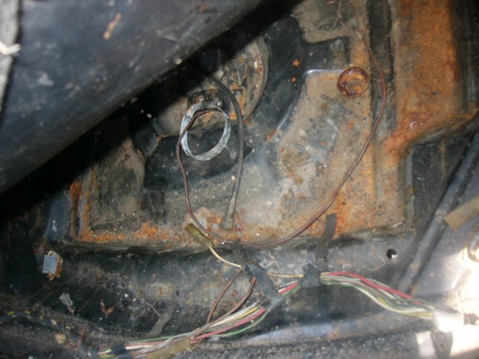

About a year ago I seen a 914 sitting on the corner for sale and it was like love at first sight.So I ran to the bank as fast as i could, pulled out 2000 smackers,and bought the car before anybody else could buy it (IMG:style_emoticons/default/wacko.gif)
Well a few months later I found this website called 914world.com,an noticed lots of people talking about rust in the battery tray area, so I went outside and took a look at my own car....Holy F*&%in shit my car was rusted all the way through to the suspension (IMG:style_emoticons/default/headbang.gif) (IMG:style_emoticons/default/headbang.gif) .........It looks like the right trailing arm mount busted at sometime or another, because the PO (IMG:style_emoticons/default/finger.gif) welded some 1/4 in steel to hold it together....
I started to look a little farther and found rust everywhere,the longs,under pass seat,everywhere.........I guess my question is would this be worth fixing myself or would it be cheaper to buy a rust free tub? Here are some pics..............

under front trunk carpet

anthony   The most economical course of action would be to b...   Jul 7 2004, 05:52 PM

Jeroen   wow... that's nasty! If you like messing a...   Jul 7 2004, 05:57 PM

morphenspectra   nasty nasty nasty..... i suggest you get a new rol...   Jul 7 2004, 06:18 PM
lapuwali   I'd buy another whole car and treat this one a...   Jul 7 2004, 06:25 PM

skline   I would start looking now though, we dont want to ...   Jul 7 2004, 06:34 PM
TonyAKAVW   I went through the very same adventure. I bought ...   Jul 7 2004, 06:45 PM

freezing14   I do not agree, with all of you, when I got mine...   Jul 8 2004, 11:21 AM
RON S.   To quote a cliche,Been There,Done That. I bought ...   Jul 8 2004, 11:37 AM
tat2dphreak   I'm sorry to say, that car's good days are...   Jul 8 2004, 11:58 AM
Dave Bell   Hmm... reminds of the last topic I posted on... I...   Jul 8 2004, 02:02 PM

bondo   Looks like repairable rust to me.. but take a clos...   Jul 8 2004, 06:24 PM
Dave Bell   $100... I paid $75 for a side shift tran...   Jul 8 2004, 06:59 PM
boxstr   Buy it and add it to your collection. CCLINTHE...   Jul 8 2004, 07:19 PM
nebreitling   it's a no brainer for $100, though the ch...   Jul 8 2004, 08:00 PM
