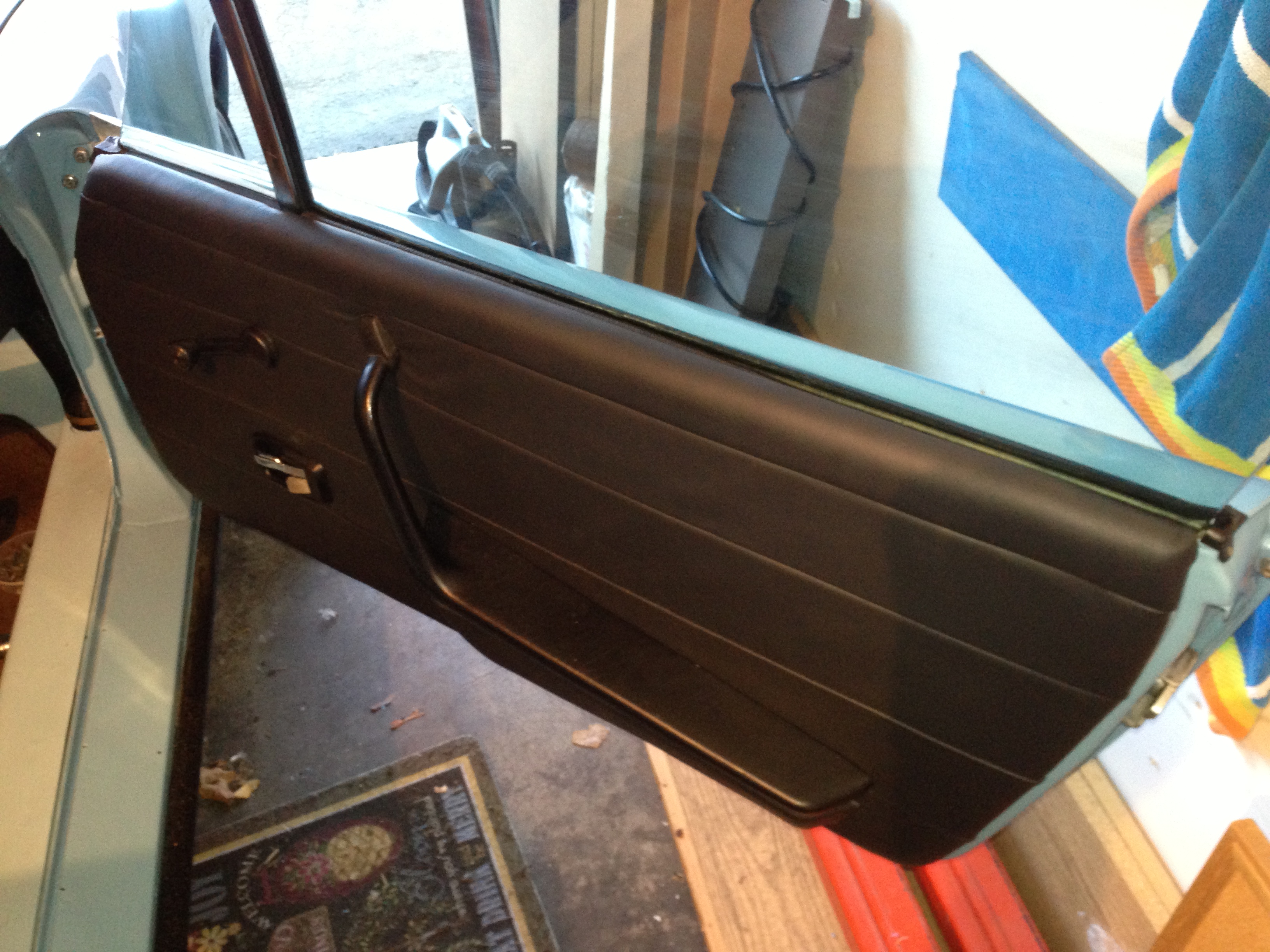

Tonight I got the passenger door panel attached. Lining up the bolts was a pain in the ass. I finely put the bolts in backwards so the stuck through the
new panel and put nuts on the interior side.
Then I worked on installing the frame that holds the ash tray. Note to anyone else who is doing a total restoration. The ash tray goes in BEFORE the dash cap.
Otherwise you need to remove the plastic nuts the hold the cap in place.
One step back...
