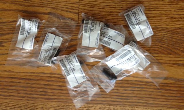

Look what came today....flywheel bolts...
These work great for the SVX. Part # is 800610740.

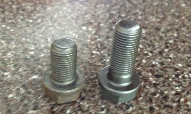

Comparison of the flex plate bolts vs. flywheel bolts. There's a joke in here, but it's too obvious...
Hey do you guys recommend using a small amount of blue loctite for these or is it not necessary? Unless someone HATES the idea I think I will.
