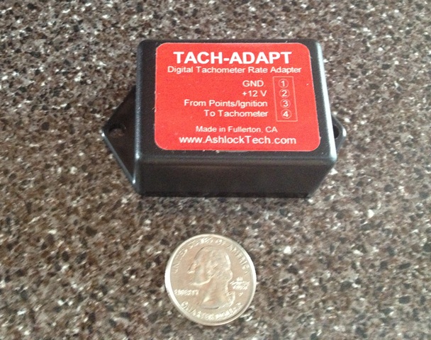

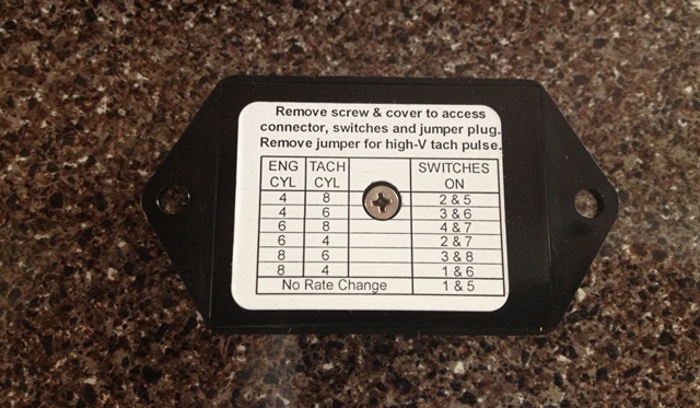

It's one of those weeks where you get a surprise every day in the mail...here's today's:
Thanks to SpeedMetalArmy for the heads-up. Apparently this thing will not only translate a 6 or 8 cylinder pulse onto your stock tack but will stop the "tach bounce" that many of us get with 4 cylinder engines. Haven't tried it yet. It's pretty compact..
