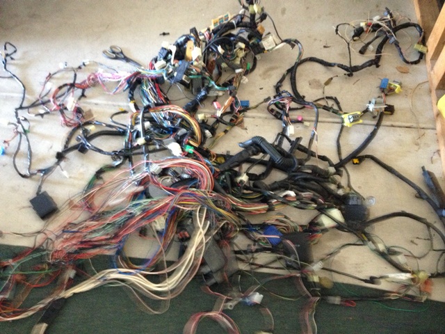

Well things have slowed down a LOT but they are about to get back on pace. Been working on the main wiring harness...FUN!
This is below "Andy's camera" quality...did I even point it at the harness?

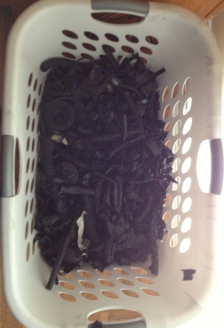

A laundry basket full of electrical tape...from unwrapping the main harness...probably a couple miles of it there.

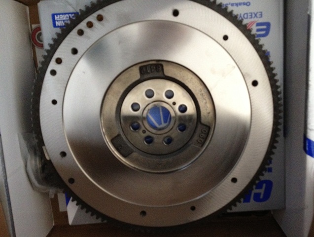

Refinished the flywheel even though it might have been OK - looks much better.

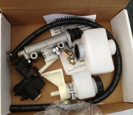

Hydraulic clutch bits...still need to decide whether to use metal or poly lines...leaning towards poly.
I ran a -3AN stainless braided PTFE line in mine. Worked great! I did buy some extra fittings and leave some slack in the line. This came in handy when the transmission side leaked during bleeding. I ran the line inside the factory clutch tube, slid in without effort.

Chris H.   Thanks guys. Got the harness out... Empty basket...   Dec 29 2012, 03:34 PM
904svo   Heres my WRX harness before and after. Label all t...   Dec 29 2012, 05:25 PM

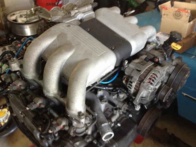

Chris H.   Just some minor updates...the exciting stuff will ...   Jan 23 2013, 06:44 AM
Chris H.   So the angle of the intake has gotten my attention...   Jan 23 2013, 06:44 AM
Chris H.   Here's a better shot of the angle... And t...   Jan 23 2013, 06:54 AM

a914622   Yes the intake can be flipped around, but the inje...   Jan 27 2013, 12:28 AM
