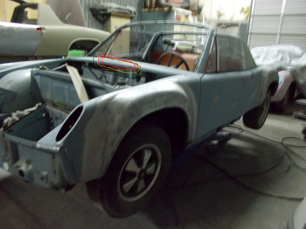

QUOTE(scotty b @ Jun 16 2013, 02:28 PM) *
Hoping to get primer on it next week
(IMG:style_emoticons/default/w00t.gif) Very nice Scotty, you (IMG:style_emoticons/default/aktion035.gif) . This pleases me very much, a nice Father's Day surprise. I (IMG:style_emoticons/default/pray.gif) you. Have you already done this area here? (IMG:style_emoticons/default/confused24.gif)

scotty b   I think Donald may be loosing it :screwy: FWIW...   Jun 4 2013, 07:36 PM

billh1963   Nice to see progress!!!!! What...   Dec 7 2013, 06:03 AM
scotty b   That pic was a month or so ago. As of yesterday, i...   Dec 7 2013, 08:51 AM
