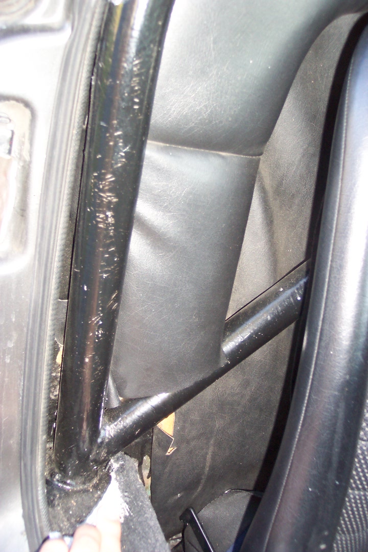

Rob Ways   Would the interior weld-in kit work well with a we...   Jul 7 2004, 07:49 PM
Jeroen   Hey Rob, You have a "petty" bar on your rollbar, ...   Jul 7 2004, 08:04 PM

Rob Ways   I have a weld in bar (tied into the rear longs and...   Jul 9 2004, 07:55 PM
Aaron Cox   rob, can you post a pic of your roll bar please ;)   Jul 9 2004, 08:03 PM
Rob Ways   OK- This first pict is the pass long tie. Note the...   Jul 9 2004, 08:25 PM
Rob Ways   Here's a pict of all the upper points. The fro...   Jul 9 2004, 08:27 PM
Rob Ways   This pict is the front pickup point welded into th...   Jul 9 2004, 08:29 PM
Rob Ways   Here's the driver's side. Note the positio...   Jul 9 2004, 08:31 PM
Rob Ways   Here's a closer look at the drivers side point...   Jul 9 2004, 08:33 PM
Rob Ways   I just had to post this one again.   Jul 9 2004, 08:34 PM
