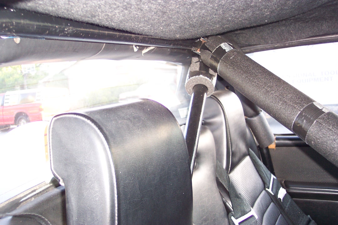

Here's a pict of all the upper points. The front bar is bolt in but not at the hinge points. When I turn hard I can feel this bar tighten.

Rob Ways   I have a weld in bar (tied into the rear longs and...   Jul 9 2004, 07:55 PM
Aaron Cox   rob, can you post a pic of your roll bar please ;)   Jul 9 2004, 08:03 PM
Rob Ways   OK- This first pict is the pass long tie. Note the...   Jul 9 2004, 08:25 PM
Rob Ways   Here's a pict of all the upper points. The fro...   Jul 9 2004, 08:27 PM
