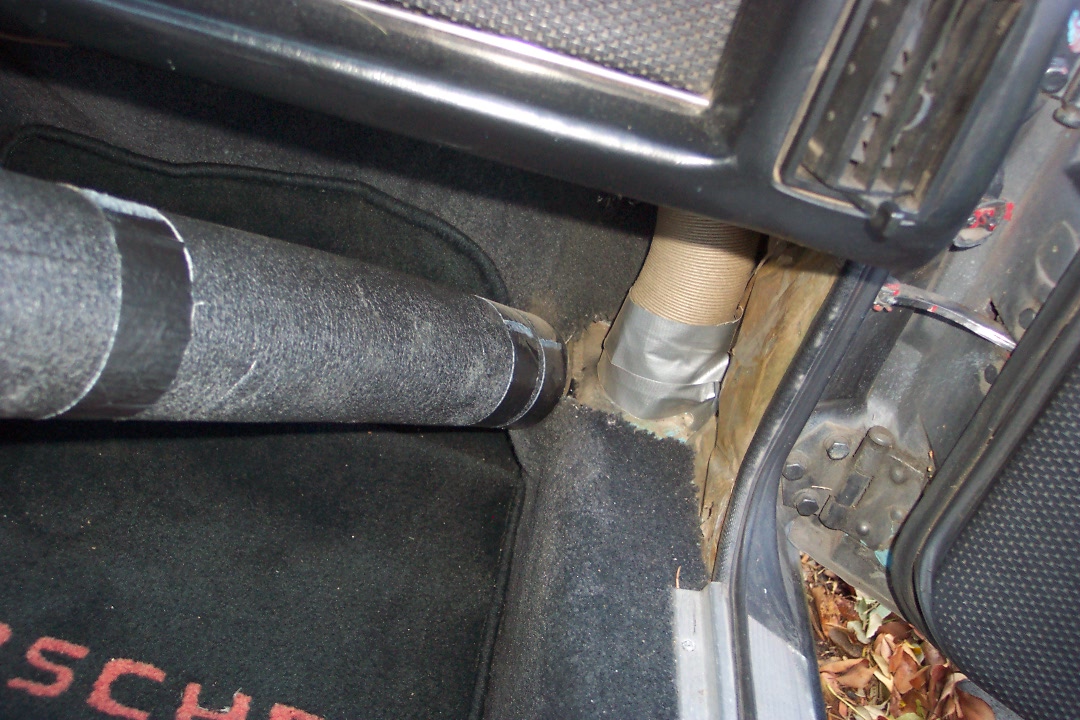

This pict is the front pickup point welded into the long. Again its bolted on but not at a hinge point. Going into the long was Brad's idea and it makes sense. The only bad thing is that when I jack up the car from the front donut, the windshield gives (cracks). This may be my car's flexy nature by itself.

Rob Ways   OK- This first pict is the pass long tie. Note the...   Jul 9 2004, 08:25 PM
Rob Ways   Here's a pict of all the upper points. The fro...   Jul 9 2004, 08:27 PM
Rob Ways   This pict is the front pickup point welded into th...   Jul 9 2004, 08:29 PM
Rob Ways   Here's the driver's side. Note the positio...   Jul 9 2004, 08:31 PM
Rob Ways   Here's a closer look at the drivers side point...   Jul 9 2004, 08:33 PM
Rob Ways   I just had to post this one again.   Jul 9 2004, 08:34 PM
