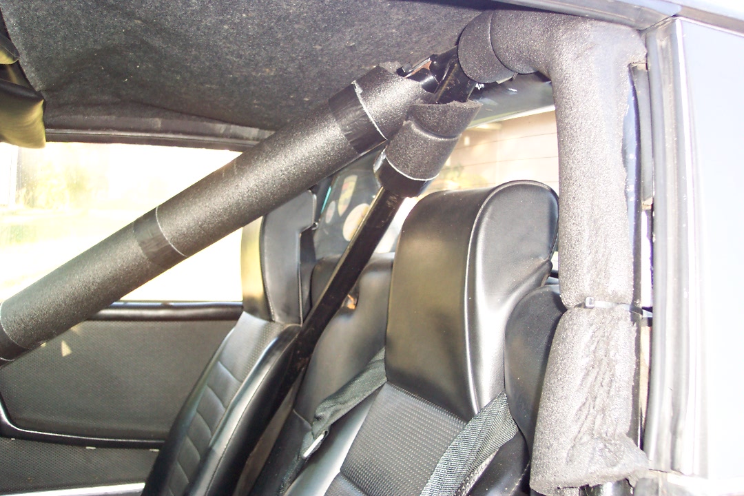

Here's the driver's side. Note the position of the front bar changes going into the side long. Looking over to the pass side blind is a chore with 5 pts on.

Aaron Cox   rob, can you post a pic of your roll bar please ;)   Jul 9 2004, 08:03 PM
Rob Ways   OK- This first pict is the pass long tie. Note the...   Jul 9 2004, 08:25 PM
Rob Ways   Here's a pict of all the upper points. The fro...   Jul 9 2004, 08:27 PM
Rob Ways   This pict is the front pickup point welded into th...   Jul 9 2004, 08:29 PM
Rob Ways   Here's the driver's side. Note the positio...   Jul 9 2004, 08:31 PM
Rob Ways   Here's a closer look at the drivers side point...   Jul 9 2004, 08:33 PM
