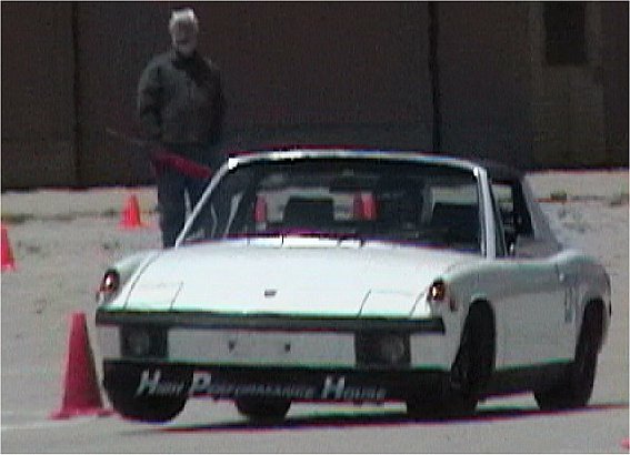

Koni yellows- full soft front, full firm rear
31mm Smart Racing front bar set 75% soft
150# Eibach rear springs
Falken Azenis 39psi front, 41psi rear
I have a stock rear bar to install this week.
Also carrying 200# springs to Alameda...just in case (IMG:style_emoticons/default/wink.gif)
I expect to look like a different driver next Saturday. (IMG:style_emoticons/default/biggrin.gif) (IMG:style_emoticons/default/cool_shades.gif)
KT
remember this?

trekkor   I'll say this about chasis stiffening coupled ...   Jul 9 2004, 09:52 PM

trekkor   Koni yellows- full soft front, full firm rear 31mm...   Jul 9 2004, 11:56 PM

trekkor   I am the experimental child. I believe the soft h...   Jul 10 2004, 12:18 AM
trekkor   Here's the car with the long lift. Don't h...   Jul 10 2004, 12:29 AM
trekkor   point of reference: here's what it looks like...   Jul 10 2004, 12:40 AM
