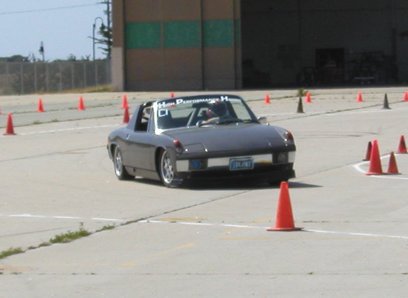

This is what it should look like.....

trekkor   I'll say this about chasis stiffening coupled ...   Jul 9 2004, 09:52 PM
Rob Ways   Passengers fit OK, but its at least 3 inches forwa...   Jul 9 2004, 11:37 PM
trekkor   Koni yellows- full soft front, full firm rear 31mm...   Jul 9 2004, 11:56 PM
Rob Ways   Why soften the front? What torsion bars? Who told ...   Jul 10 2004, 12:01 AM
Rob Ways   This is what it should look like.....   Jul 10 2004, 12:07 AM
trekkor   I am the experimental child. I believe the soft h...   Jul 10 2004, 12:18 AM
