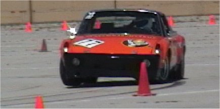

I am the experimental child.
I believe the soft help eliminate understeer along with the stiff rear end.
Stock torsion bars.
Brad is the designer- I just pay and play! (IMG:style_emoticons/default/lol2.gif)
FYI- Bill, Randal and the Jagermiester six car all lift.
I saw a car in Reno carry the front wheel 200 ft around a sweeper. They placed high up.

trekkor   I'll say this about chasis stiffening coupled ...   Jul 9 2004, 09:52 PM
Rob Ways   Passengers fit OK, but its at least 3 inches forwa...   Jul 9 2004, 11:37 PM
trekkor   Koni yellows- full soft front, full firm rear 31mm...   Jul 9 2004, 11:56 PM
Rob Ways   Why soften the front? What torsion bars? Who told ...   Jul 10 2004, 12:01 AM
Rob Ways   This is what it should look like.....   Jul 10 2004, 12:07 AM
trekkor   I am the experimental child. I believe the soft h...   Jul 10 2004, 12:18 AM
trekkor   Here's the car with the long lift. Don't h...   Jul 10 2004, 12:29 AM
trekkor   point of reference: here's what it looks like...   Jul 10 2004, 12:40 AM
Rob Ways   I shouldn't drive and tell... but the rear bar...   Jul 10 2004, 12:43 AM
Rob Ways   Oh, the Jagermeister car is N/A IMO   Jul 10 2004, 12:43 AM
Rob Ways   I dig the last picture and how you are leaning you...   Jul 10 2004, 12:45 AM
Rob Ways   I know this sounds crazy too, but I think the roll...   Jul 10 2004, 12:49 AM
trekkor   Come to Alameda, Rob. I have not run the stiff ki...   Jul 10 2004, 01:08 AM
Rob Ways   Thanks for the offer. I've got kid duty but ...   Jul 10 2004, 01:15 AM
trekkor   Rob, I was putting new wheels on today and when I ...   Jul 10 2004, 01:22 AM
Rob Ways   The latteral stiffness is there with my forward ba...   Jul 10 2004, 01:38 AM
trekkor   The first thing Brad noticed about my car when it ...   Jul 10 2004, 01:48 AM
