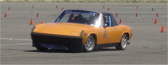

Here's the car with the long lift.
Don't have it lifting on "film" though.
All these fast cars that lift, why? To stiff front bar?
Is it understeer forcing the inboard wheel up?
I'm scared (IMG:style_emoticons/default/unsure.gif)
