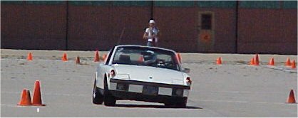

point of reference:
here's what it looks like with worn out stock suspension.
Same venue, similar turn, speed.

trekkor   point of reference: here's what it looks like...   Jul 10 2004, 12:40 AM
