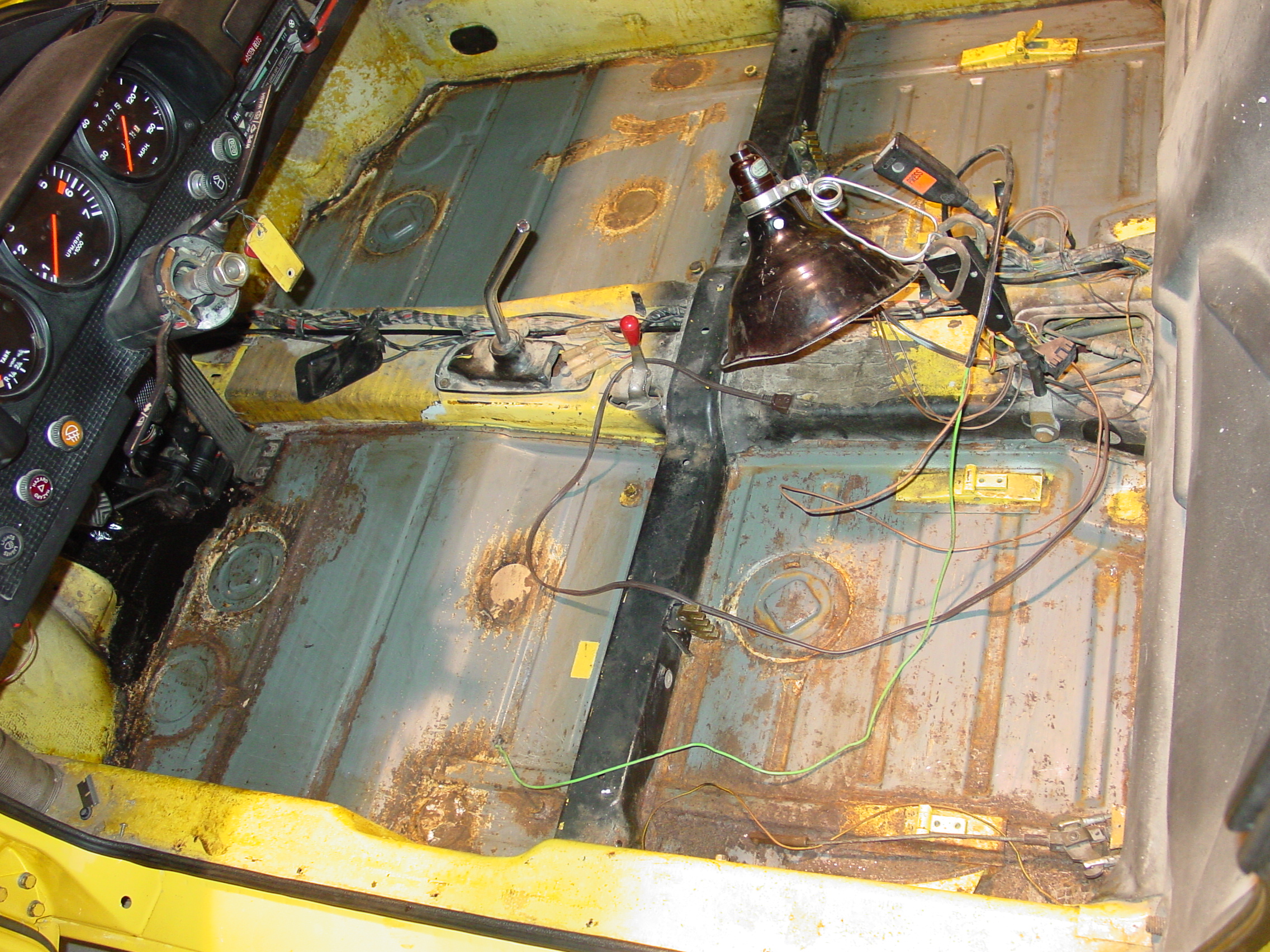

as noted, you find probably find more issues if you remove the tar. a heat gun, a painters 5-way tool, an afternoon and you'll know for sure.

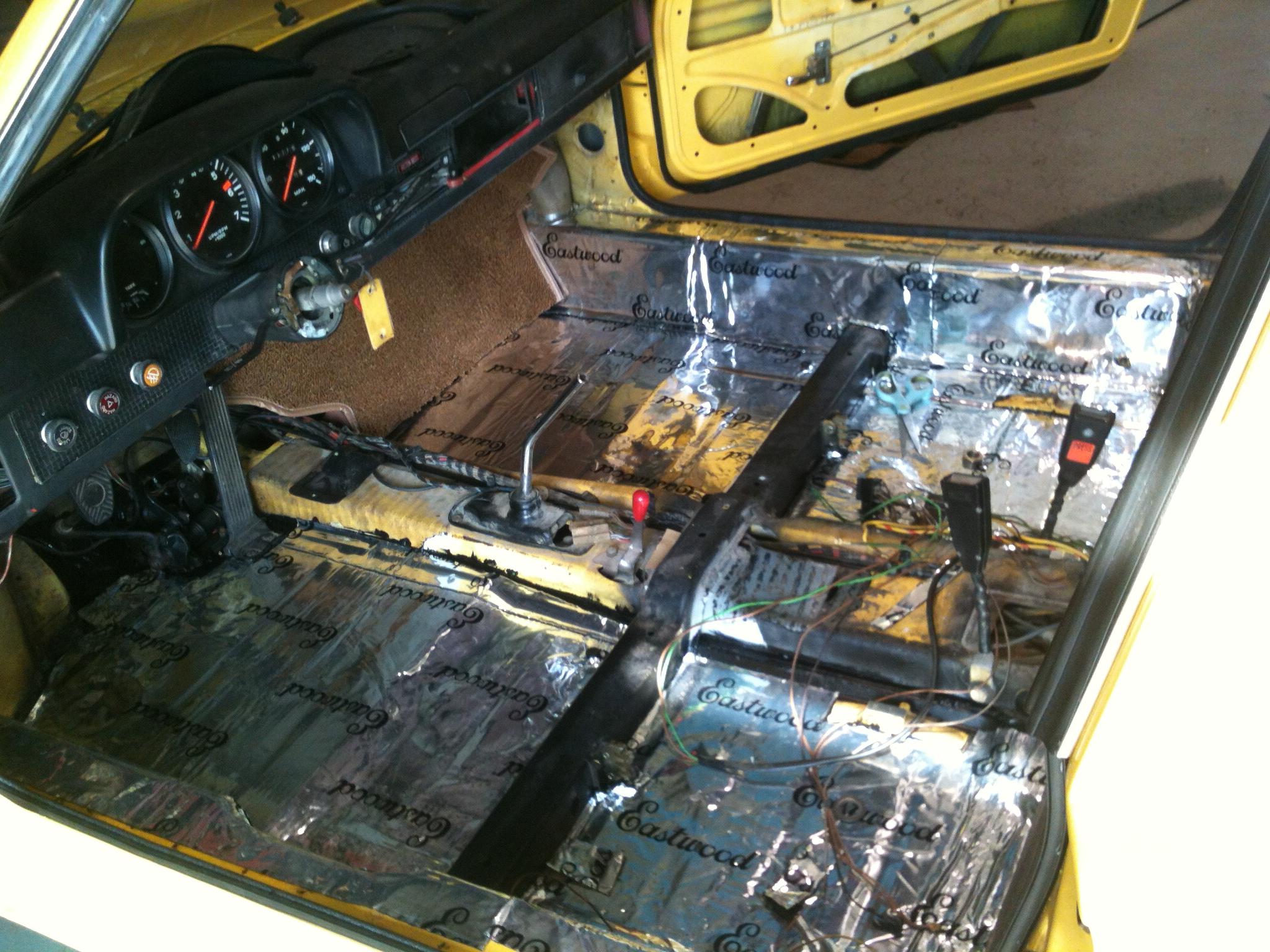

I used a mapp gas torch. All you need to to warm an area a few inched at a time. I used an 1/2" wood chisel. I removed all the tar in less than 2 hours. You will find more rust. This is the time to get it. I used East wood sound deadening material.
