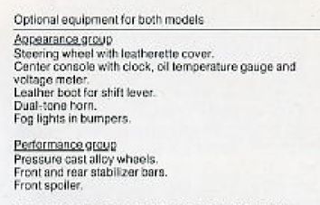

You might want to look into the center console. In the 1973 model year 2.0Ls, lots of the otherwise optional equipment items were standard, but in 1974, these became optional and the equipment groups changed composition.
Your chrome bumpers would have been an extra cost option in 1974, are they shown that way on the COA? Here is a list of separate optional equipment items for all years:
http://bowlsby.net/914/Classic/OpEq.htm

QUOTE(Jeff Bowlsby @ Jun 30 2013, 01:31 AM) *

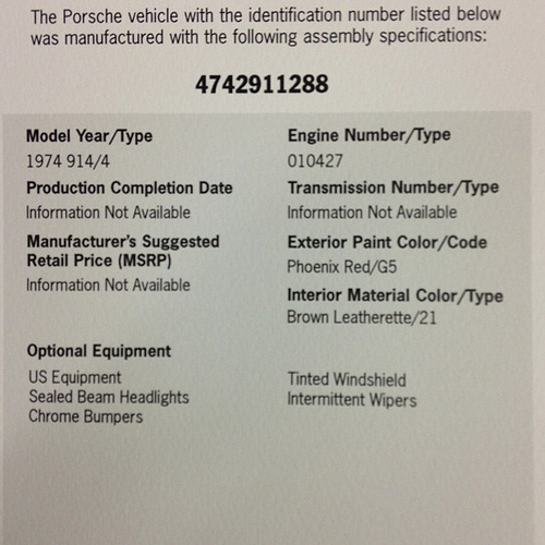

My COA:
(IMG:http://www.914world.com/bbs2/uploads_offsite/farm4.staticflickr.com-7438-1372634986.1.jpg)
Just "Chrome Bumpers!" And my car has fog lights as well as the center console. I mean, this thing has the wiring harness in place for the console. And I know for a fact from the original owner's son that the chrome bumpers were not parted out for other fog light bumpers and the console was not added separately. With the COA as it is, I'm not so sure the Monroney sticker would be any better (but it is, alas, unavailable).
Any ideas, Jeff?
