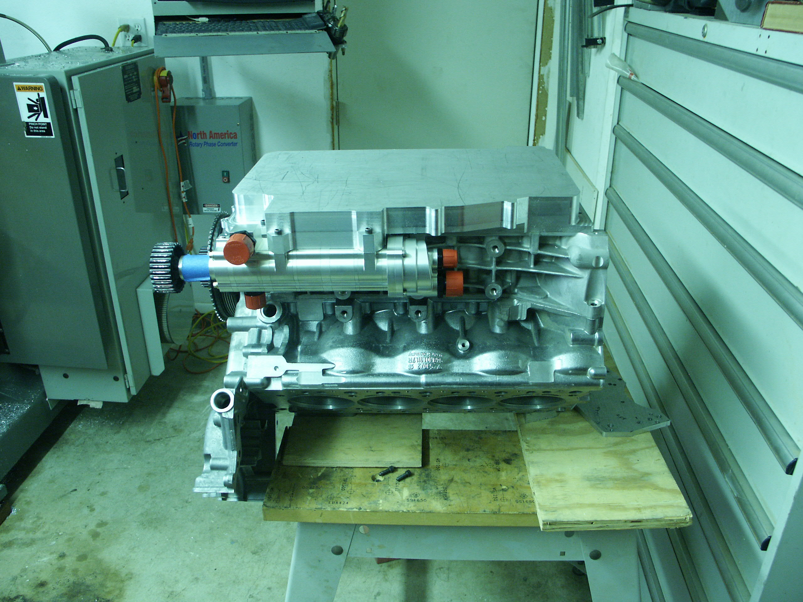

Maltese Falcon   The new cnc aluminum oil pan , now 100% dry sump a...   Jul 1 2013, 06:33 PM
Maltese Falcon   Another oil pan view   Jul 1 2013, 06:48 PM

Maltese Falcon   S'more machine work on the oil pan, dry sump c...   Jul 3 2013, 12:32 AM
Maltese Falcon   Just enough room in the edge (left +right )of the...   Jul 13 2013, 12:57 AM
