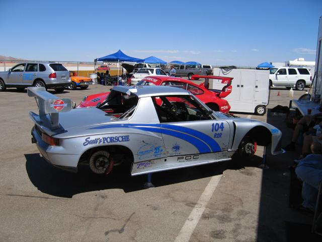

I spent the weekend at the NASA event at Willow Springs. It was pretty fun, and a very fast track - 125 on front stretch, about 105 or so on the back stretch. Turn 8/9 right at about 90/100 mph. Yowzers. I had never driven on that fast of corners before.
It think it was about 105 degrees out too, and my car started to get too hot in the afternoon sessions. I actually had to stop the 20 minute run sessions early. I was quite surprised by this, as I had previously been concerned that the car is running too cool on the freeways. Hmmm...
I'm running a 3.6 with a front mounted Mocal cooler that's 20x6x2 or so. Another 914 there had a 4.0 (from a 3.6) with the factory C2 cooler under the rear trunk AND a front mounted cooler that was 16x6x2 or so.
I think my DME programming might still be a little off (too lean) contributing to the heat. I'll have to check it out.
Does anyone have any real world experience with the GT engine lids? Do they really make a cooling difference? Anything else to consider besides fuel/timing and engine lid before I start cutting away for a second cooler somewhere?

brant   I don't know that a front mounted cooler would...   Jul 12 2004, 05:14 PM
drew365   My car had an under rear trunk cooler and fan and ...   Jul 12 2004, 05:51 PM
siverson   > how high were the temps getting? 245 and then I...   Jul 12 2004, 08:08 PM
campbellcj   Steve - glad to hear you had a fun day. I'm r...   Jul 12 2004, 10:34 PM
siverson   > What kind of ducting setup does your cooler have...   Jul 13 2004, 01:18 AM

Jack Olsen   It's not easy to keep a 3.6 cool. The cars th...   Jul 13 2004, 02:38 AM
1973914   Saw a 3.6 track-only car that had 2 coolers that s...   Jul 13 2004, 06:25 AM

john rogers   When Chris Burns was racing his RSR motored 914 se...   Jul 14 2004, 12:59 PM
Racer Chris   The lack of an air dam definitely hurts you, big t...   Jul 14 2004, 05:19 PM

siverson   Thanks for all the good tips. My to do list is gro...   Jul 14 2004, 05:54 PM
siverson   Yeah, I'm sure it's better to vent the air...   Jul 14 2004, 05:55 PM
