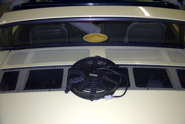

Steve, nice car, nice pictures. You are my hero..I only run the 'Streets' and sure don't do it July through Sept. How high is your temp?
My 2.0 4 has GT lid and small rear mounted oil cooler, and yes, it's hard to get oil to 200 in even spirited street driving. Track only get to 220. Apparently was a concern to PO also, as a JAZ condensor tank was installed. It seems to do a good job of trapping condensation.
The GT lid 'may' help cool intake temps, but I'll bet it does nothing oil temp. How about mounting a fan on the oil cooler? You could switch activate when needed. Here's my engine lid and kind of fan I mentioned.
