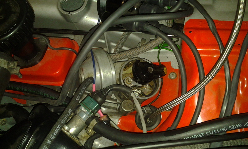

Can you post a pic of the rotor, so we can see which way it's pointing?
malcolm2
post Jul 9 2013, 11:35 PM
Posts: 2,749
Joined: 31-May 11
From: Nashville
Member No.: 13,139
QUOTE(timothy_nd28 @ Jul 10 2013, 12:28 AM) *
Straight right (passenger side)
