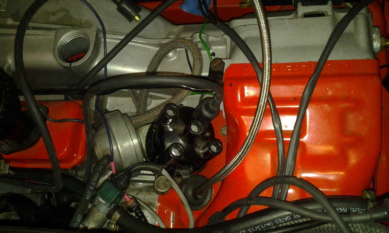

timothy_nd28   Can you post a pic of the rotor, so we can see whi...   Jul 9 2013, 11:28 PM
malcolm2   Can you post a pic of the rotor, so we can see wh...   Jul 9 2013, 11:35 PM
timothy_nd28   Ok, put the cap on and put only the number one plu...   Jul 9 2013, 11:38 PM
malcolm2   Ok, put the cap on and put only the number one pl...   Jul 9 2013, 11:44 PM
