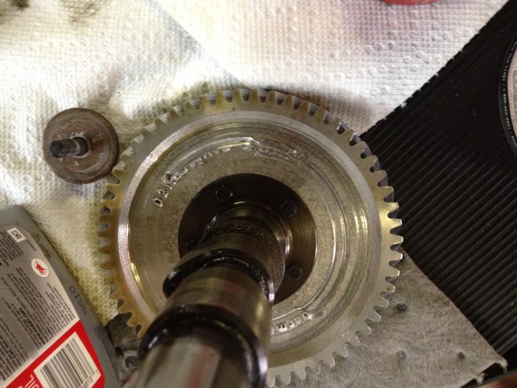

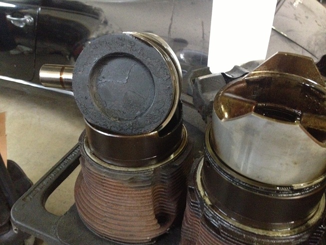

My engine's apart. The Cylinders have enough pitting and scratching that I will probably go ahead and replace. And are these bus pistons???
(Assuming they are, I'm very confused... thought this engine had never been apart, but I've only owned it for 4 of its 40 years!)
There's some carnage from some loose metal - fortunately, no significant damage to the Crank or the Case. But look closely at the cam gear:
So now I need to decide what Ps & Cs to get, and what cam. It's a 2.0 case, running EMPI 40mm carbs. Primary concern is drivability - this is a street car, not a race car... but power (and to some extent, fuel economy) are considerations too. Who makes Ps & Cs that bring it up to 2056? What CR should I be targeting? and what cam?
