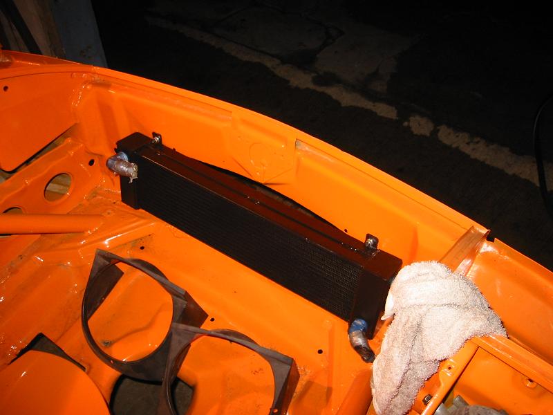

I spent the weekend at the NASA event at Willow Springs. It was pretty fun, and a very fast track - 125 on front stretch, about 105 or so on the back stretch. Turn 8/9 right at about 90/100 mph. Yowzers. I had never driven on that fast of corners before.
It think it was about 105 degrees out too, and my car started to get too hot in the afternoon sessions. I actually had to stop the 20 minute run sessions early. I was quite surprised by this, as I had previously been concerned that the car is running too cool on the freeways. Hmmm...
I'm running a 3.6 with a front mounted Mocal cooler that's 20x6x2 or so. Another 914 there had a 4.0 (from a 3.6) with the factory C2 cooler under the rear trunk AND a front mounted cooler that was 16x6x2 or so.
I think my DME programming might still be a little off (too lean) contributing to the heat. I'll have to check it out.
Does anyone have any real world experience with the GT engine lids? Do they really make a cooling difference? Anything else to consider besides fuel/timing and engine lid before I start cutting away for a second cooler somewhere?
-Steve

Cooler while being installed:

siverson   Cooler while being installed:   Jul 13 2004, 01:22 AM
