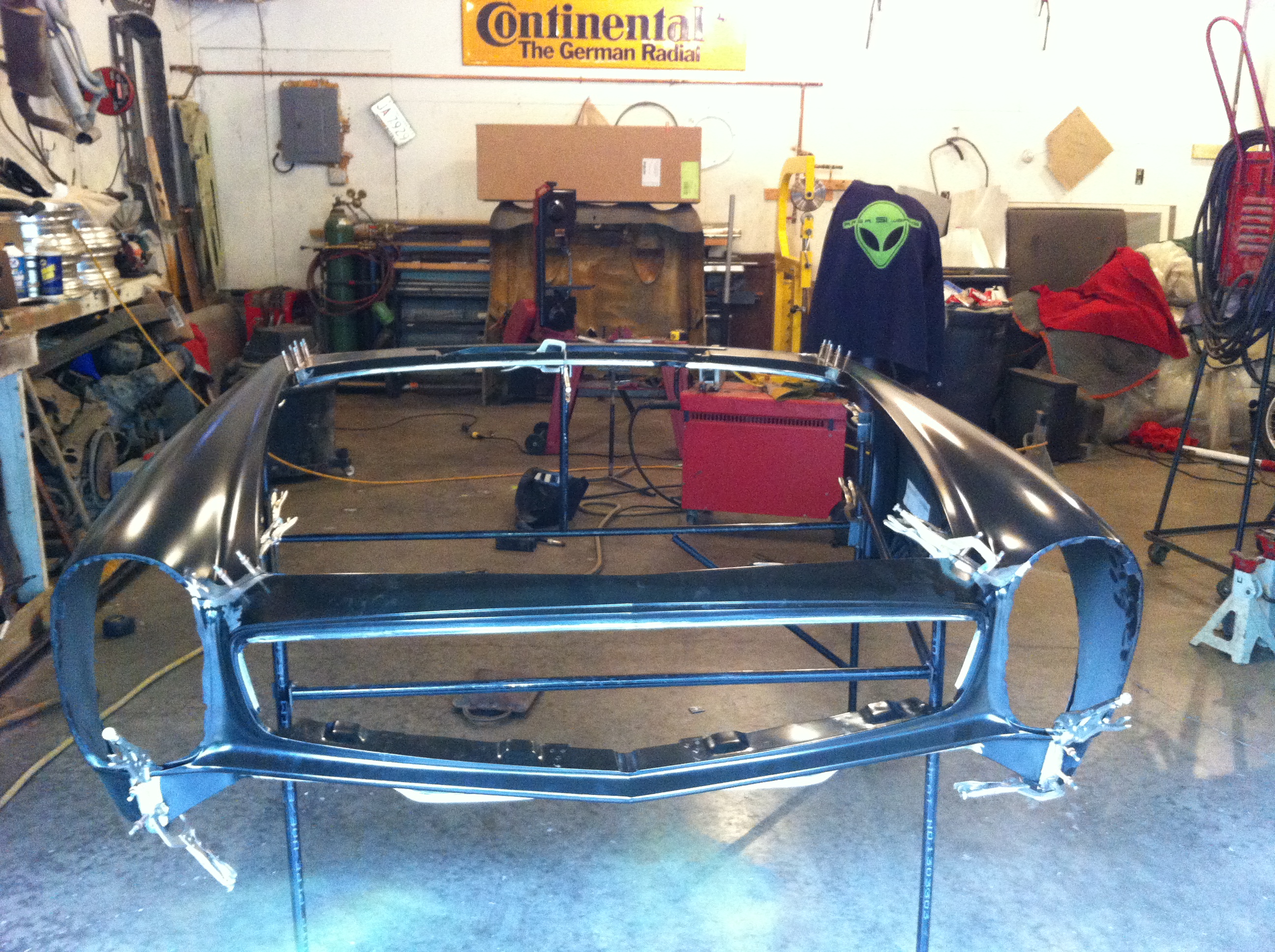

This Mercedes is even challenging my skill set. The factory used to sell the front shroud as a complete unit. It is not available that way anymore so I need to assemble all the pieces and metal finish all the seams before sliding the shroud over the inner structure.
Now in case you don't know the lids and doors are aluminum. The sheet metal is assembled, then the doors and lids are filed to fit the openings. The gaps are perfect and set to 5mm from what I'm told.
So as I assemble the car I have to fit sheet metal parts that is normally welded "close" and fit by hand to the doors and lids that are filed to fit the sheet metal. (IMG:style_emoticons/default/screwy.gif) Not easy.
Here's the shroud As I build it. I hope it fits.... (IMG:style_emoticons/default/unsure.gif)
Here's the first metal finished seam from the cowl to the fender.
