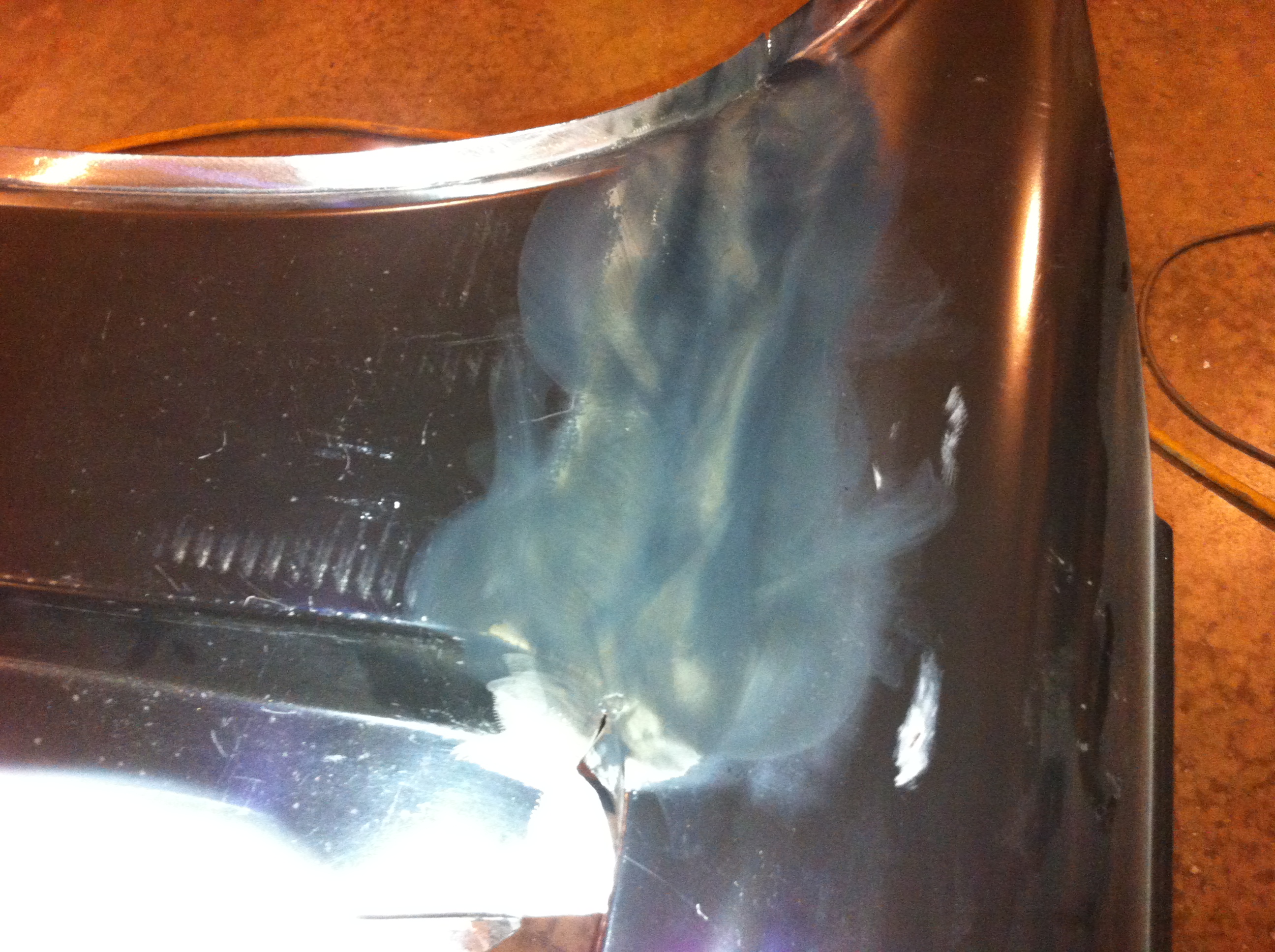

Part of the process when metal finishing is to Anneal the area you want to work. Here is a photo of the process. First you blow acetylene soot on the area you want to anneal. Then using a torch you work the area burning off the soot. Just enough to dissolve the soot and not over heat the metal. You want to relax the molecules not distort the panel.
Here is the second seam after metal finishing.
