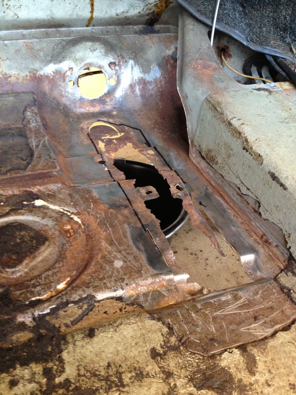

So today I was going to put in a new gas pedal since the old one wobbled and the hinge was shot. First indication of trouble was that the bolts would not come out of the old pedal, too rusted. After drilling them out and digging around a bit, I can now see the road from the driver seat. :-(
So what is the best method of repair here? Can I replace the supporting (and very rusted) metal under the floor board? I looked a bit but did not find this part in any diagrams. Who else has seen this issue?

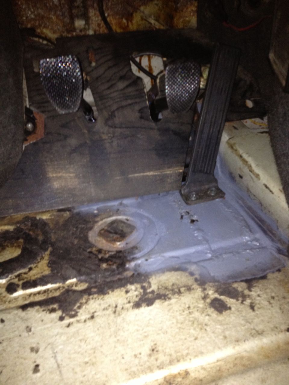

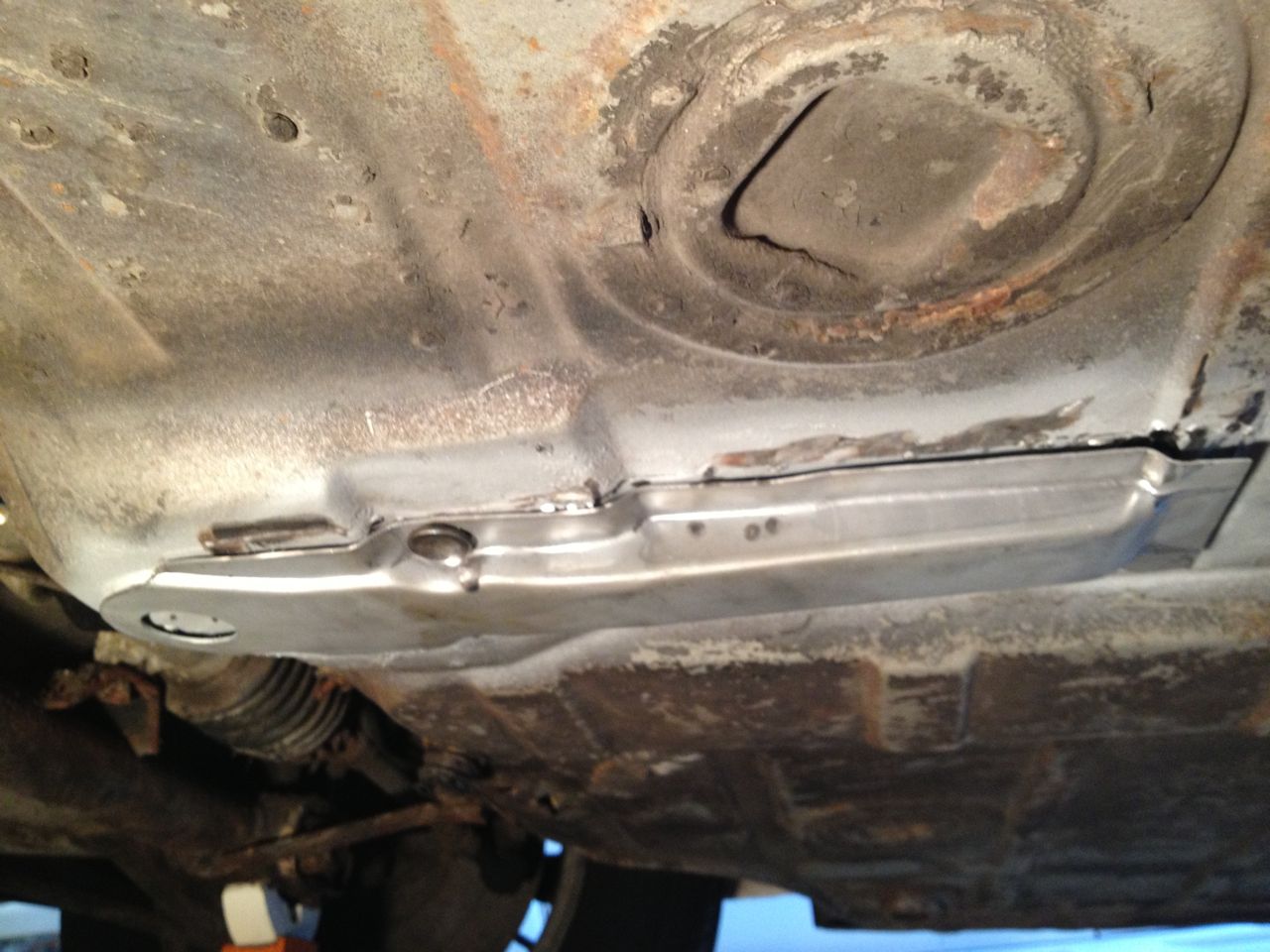

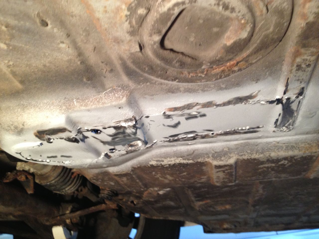

My car is back on the road! Thanks everyone for your help in finding the pedal reinforcement part from Restoration Design.
I'm adding pictures, but take it easy on me, this is the first metal fab that I have done since metal shop in high school (30 some years ago)
