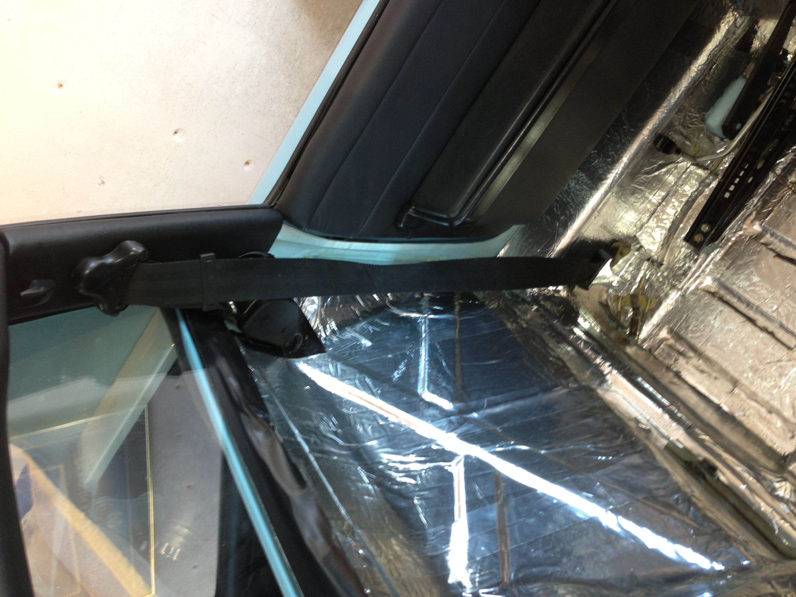

I installed the seat belts, although i know I'll need to pull them out again when the carpet goes in. I'll also need to pickup a set of "PRESS" stickers for the belts as these have long ago faded
