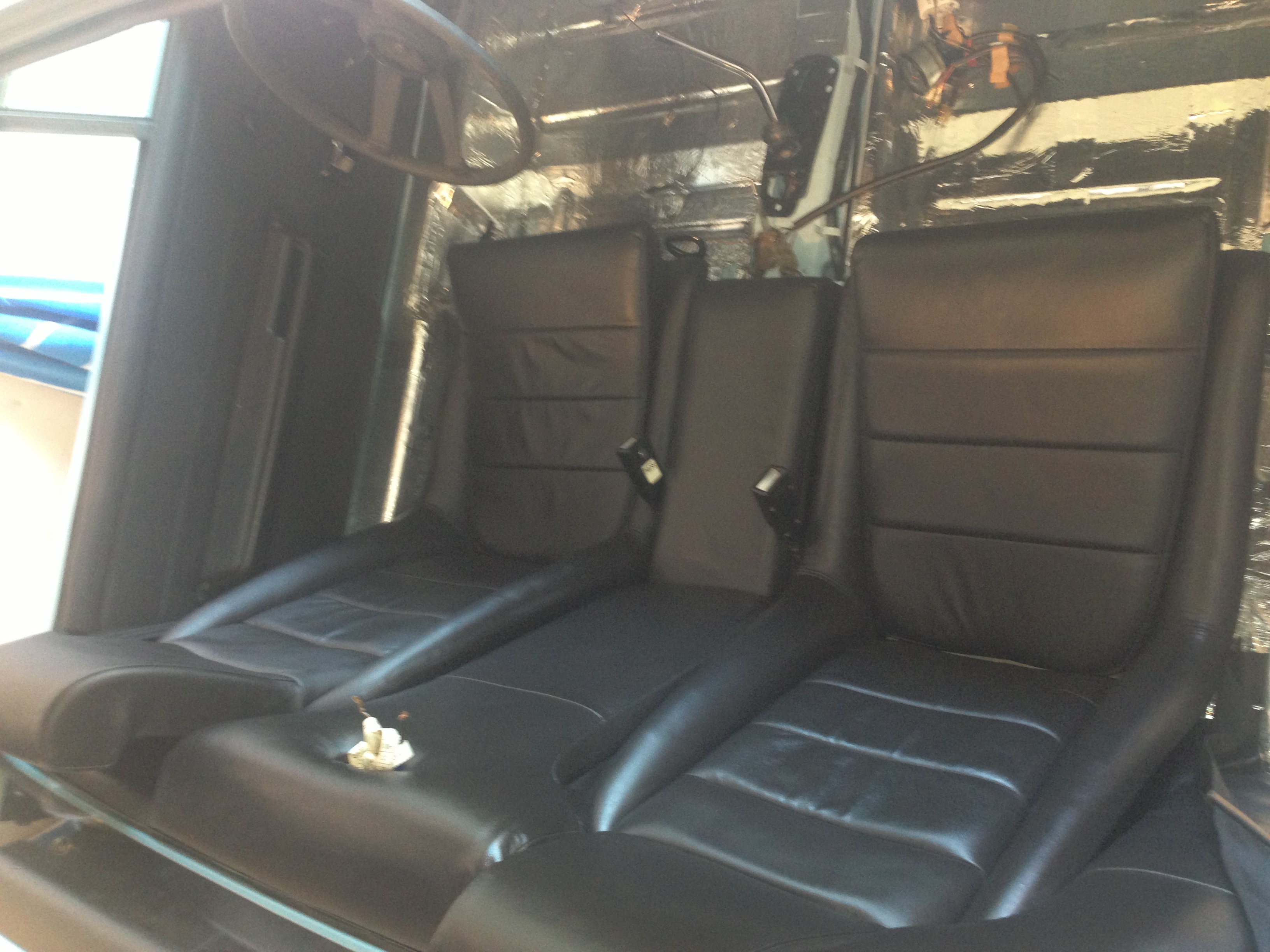

Seats were installed

PanelBilly   Seats were installed   Jul 22 2013, 08:51 PM
