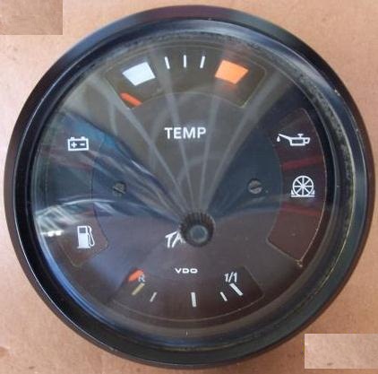

Kent, I'm just about to pull the engine! Planning for this weekend.
Also think I figured out what to do for a water temp gauge. The 924 combo gauge is allegedly the same diameter as the 914 (100mm). It has water temp, fuel level, plus all the warning lights we need (oil pressure, alternator, low fuel, brake). It has a pointed plastic bezel, but I'll either swap that out for a flat piece of glass or swap the guts into the 914 combo gauge. Not sure if the fuel gauge will work well, but I can cannibalize my current one if need be. For $25 you can't go wrong.
Pic of a similar gauge from the interweb:
