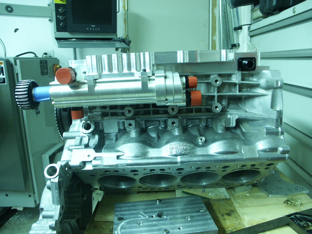

Maltese Falcon   The new cnc aluminum oil pan , now 100% dry sump a...   Jul 1 2013, 06:33 PM
Maltese Falcon   Another oil pan view   Jul 1 2013, 06:48 PM
Woody   :popcorn:   Jul 1 2013, 07:52 PM
rick 918-S   Nice work on that pan.   Jul 2 2013, 04:30 AM
Maltese Falcon   Thank you Rick !   Jul 2 2013, 09:37 AM
Maltese Falcon   S'more machine work on the oil pan, dry sump c...   Jul 3 2013, 12:32 AM
Maltese Falcon   Just enough room in the edge (left +right )of the...   Jul 13 2013, 12:57 AM
