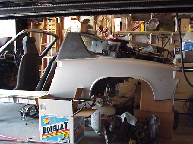

Gint   OK, so I had a beer during the course of the work....   Apr 26 2003, 07:45 PM
Brad Roberts   What are you putting Rotella in ??? Does it reall...   Apr 27 2003, 01:36 AM
Gint   Nothin. That's the box the FLAPS gave me when...   Apr 27 2003, 07:52 AM
