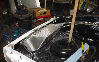

siverson   > What kind of ducting setup does your cooler have...   Jul 13 2004, 01:18 AM
siverson   Cooler while being installed:   Jul 13 2004, 01:22 AM
siverson   Cooler shroud:   Jul 13 2004, 01:22 AM
