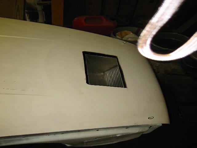

siverson   > What kind of ducting setup does your cooler have...   Jul 13 2004, 01:18 AM
siverson   Cooler while being installed:   Jul 13 2004, 01:22 AM
siverson   Cooler shroud:   Jul 13 2004, 01:22 AM

campbellcj   Actually in looking at your pic, I realized my coo...   Jul 13 2004, 08:49 PM

campbellcj   Here's a few (kinda lame) pics of my cooler se...   Jul 14 2004, 11:13 PM
campbellcj   It's hard to see in this pic (black on black) ...   Jul 14 2004, 11:17 PM
campbellcj   Oops forgot the pic   Jul 14 2004, 11:18 PM
TimT   Here is my front end set up.. I formed a piece of ...   Jul 17 2004, 07:45 PM
TimT   forgot the pic   Jul 17 2004, 07:46 PM
