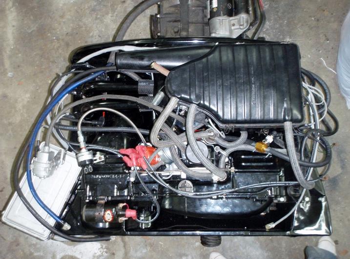

Update:
Engine is good to go. (IMG:style_emoticons/default/piratenanner.gif) (IMG:style_emoticons/default/piratenanner.gif) (IMG:style_emoticons/default/piratenanner.gif) (IMG:style_emoticons/default/piratenanner.gif) (IMG:style_emoticons/default/piratenanner.gif)
Replaced the cracked part and its ready to back in the car. Tony said I am the next car on the lift, either tommorow or Friday. I am gonna cross my fingers.
I did look at the dyno sheet, I will post it when I get the sheet in my hand.
I saw highest number was 130hp (IMG:style_emoticons/default/biggrin.gif)
I also saw 144 torque, with all the numbers very high across the whole range. WOW
This is a 2056 w/ D-Jetronic in case you guys forgot.
