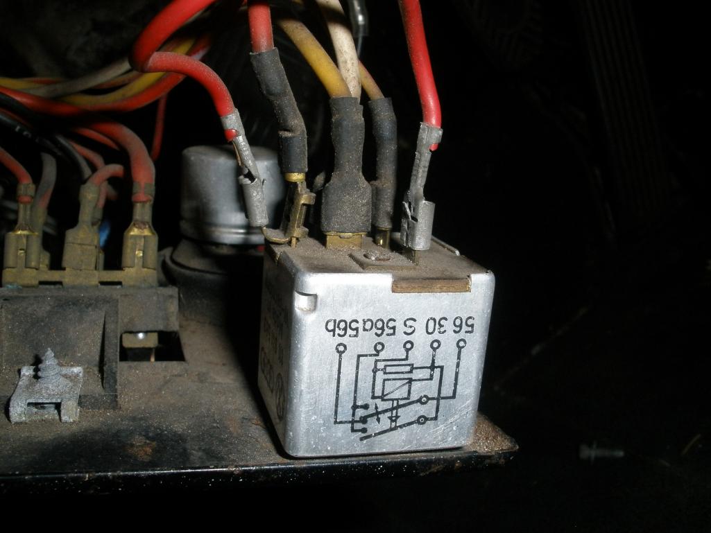

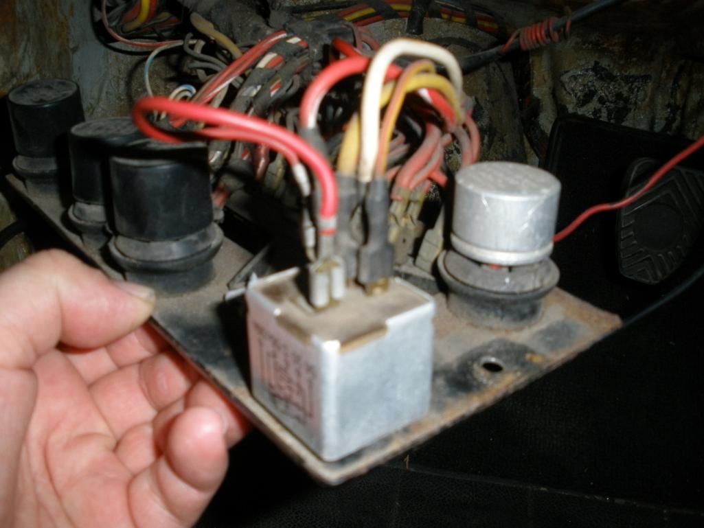

Interesting. Today I found what I think is the wiper relay (see pic/s) and I'm not sure if it's the right relay. It says on the side #111 94 583. Is that the right wiper relay part number for a 1973? I'm not even sure if it's wired properly (note jumper wire-not even sure if that's supposed to be there). The PO said the wipers did work (at some point).
Still stumped (IMG:style_emoticons/default/headbang.gif)
