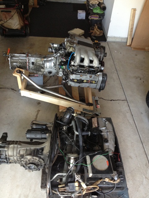

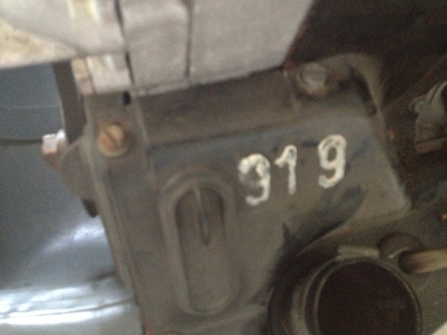

Got the old engine out! I'm feeling a little bad about the engine swap but I think I'll get over it. The 1.8l is so original and unmolested... (but dusty)

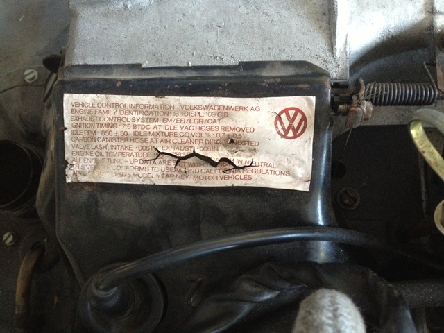

Amazingly similar....

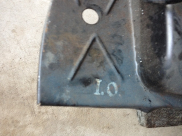

What do these numbers mean?
a 1.0L!?

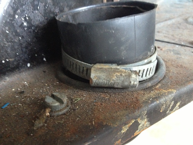

All the heater tube clamps are the original VW embossed ones...

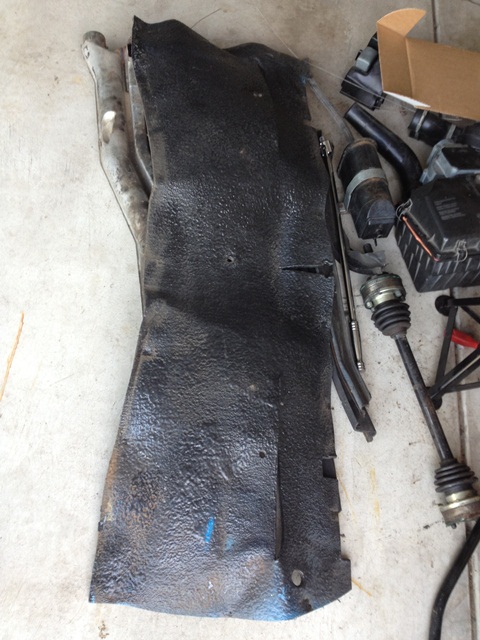

Back pad is awesome - just some paint on it but otherwise very good.

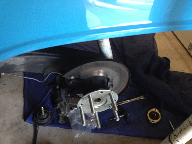

Got the rear hubs pressed

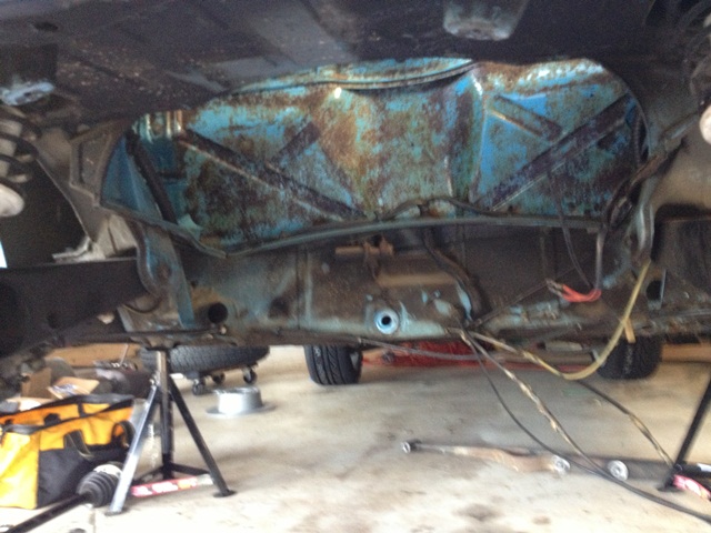

Engine hole - anyone know how to remove the glue that holds the back pad on? The paint under it is pristine!!!
