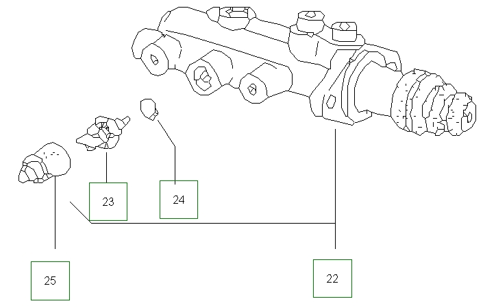

QUOTE(lawrencedesigns @ Jul 15 2004, 12:21 AM)
New owner/member here. So....what do you do when you remove the left wheel, peer into the darkness, find the master cylinder, and there is NO button.
I just pulled the wire to stop the tick tick tick until I rebuild the brake system. But what am I missing?
Keeth Lawrence
76 914 restoration project
First off, I would recommend a flashlight. (IMG:style_emoticons/default/biggrin.gif)
Anyway, the button is hidden under a rubber boot. In the crappy picture below, the rubber boot is #25 and the button (warning switch) is #23. You can press down on the rubber boot to reset the switch.

SLITS   Go to the MC and reset the switch - consult your m...   Jul 12 2004, 05:35 PM
sgomes   You have to reset the pressure sensor on the maste...   Jul 12 2004, 05:36 PM
scotty   :agree: remove the "gravel shield" and there you a...   Jul 12 2004, 05:40 PM
SirAndy   yupp, :agree: what they ^^^ say ... gotta get t...   Jul 12 2004, 05:51 PM
Part Pricer     Jul 12 2004, 06:43 PM
stecz   I remembered hearing something about a reset switc...   Jul 12 2004, 07:00 PM
stecz   Well that was easy... just turn the wheel, reach i...   Jul 13 2004, 07:51 AM
