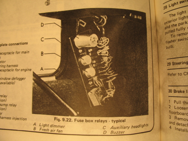

Additional information-In another post I found that the relay for the wiper is supposed to be above the fuse panel and accessable by removing the two screws that hold the panel in. I did this but can anyone identify the relays and a test for same? Here's a picture-

Jwest is a forum vendor and offers the fuse panel.
JWest Panel
This is a pic out of the haynes manual for an early car.
(IMG:http://www.914world.com/bbs2/uploads/post-2460-1357330116.jpg)
