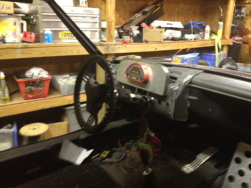

d914   Wiring is 70% done... using hot rod Harness and wi...   Apr 6 2013, 11:51 AM

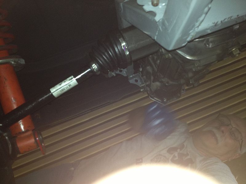

d914   Played with the car a little today. installed Rac...   Aug 4 2013, 03:47 PM
d914   RE: suby turbo , the epic   Aug 4 2013, 04:01 PM
d914   sorry only blurry shots of this..   Aug 4 2013, 04:04 PM

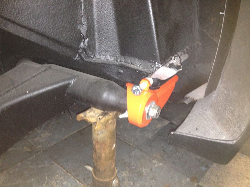

d914   New shocks,, Rebel racing tops, UB Machine bottom....   Oct 6 2013, 12:02 PM
d914   Finally on the ground and headed home for finishi...   Oct 6 2013, 12:06 PM
d914   Still needs to be adjusted.. a bit lop sided.... ...   Oct 6 2013, 12:07 PM
