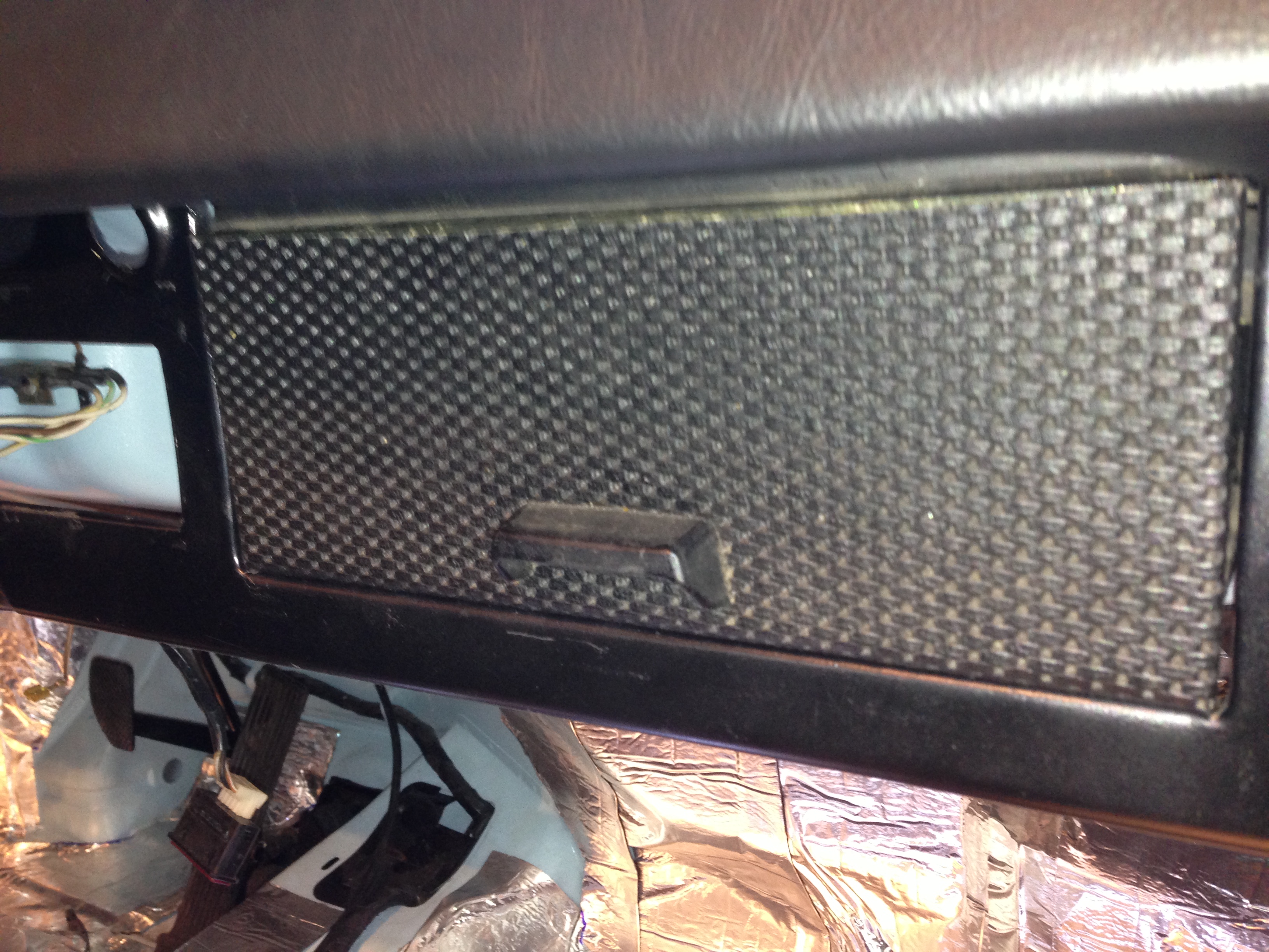

PanelBilly   I got this crazy idea to make my own fabric dash f...   Jul 22 2013, 08:54 PM
PanelBilly   Here's the basketweave   Jul 22 2013, 09:29 PM
PanelBilly   I got the glove box door installed now and the spr...   Aug 6 2013, 11:19 AM
PanelBilly   its much easier if the vents are removed   Aug 6 2013, 11:21 AM
