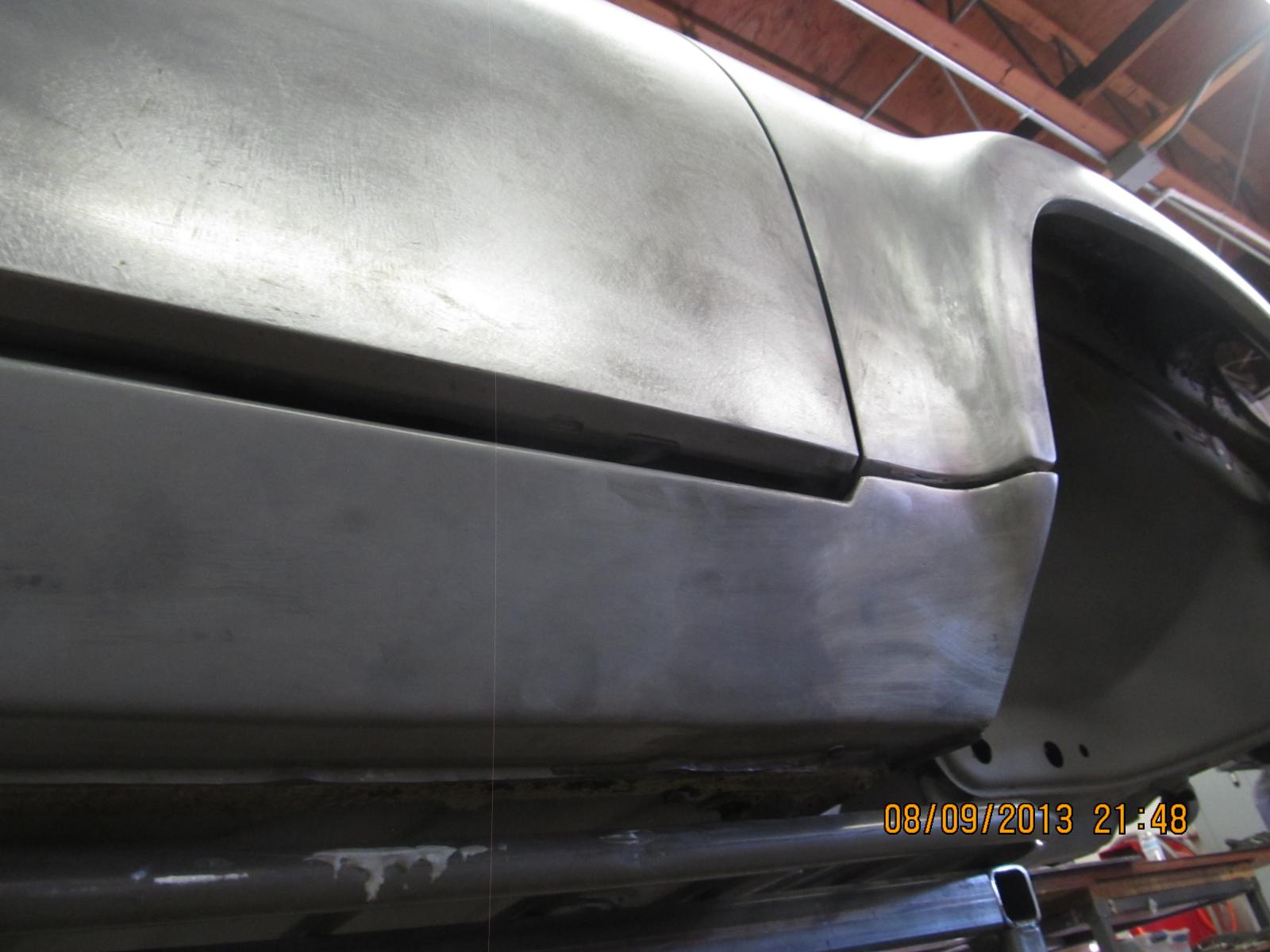

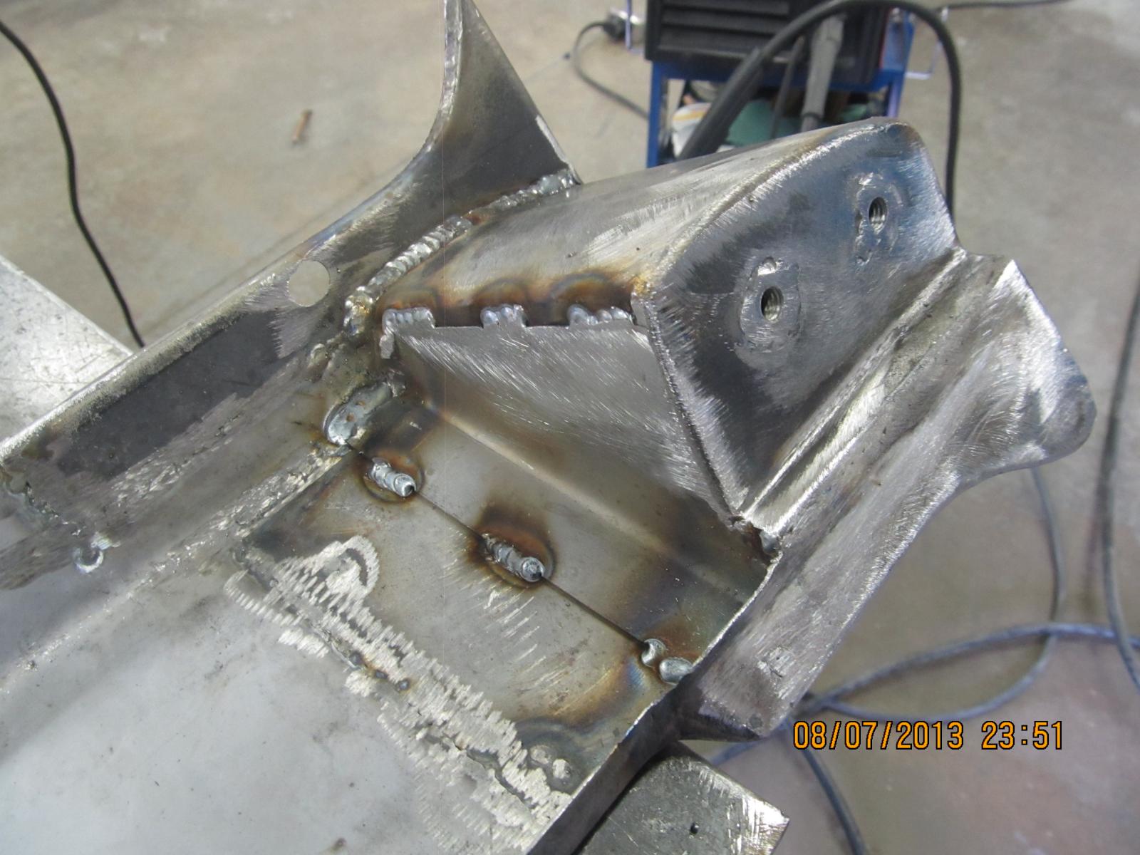

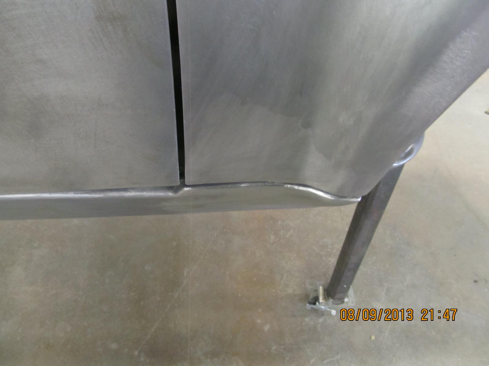

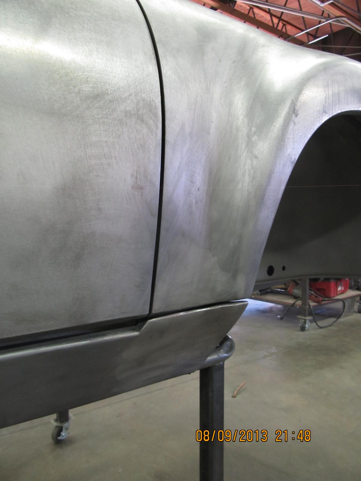

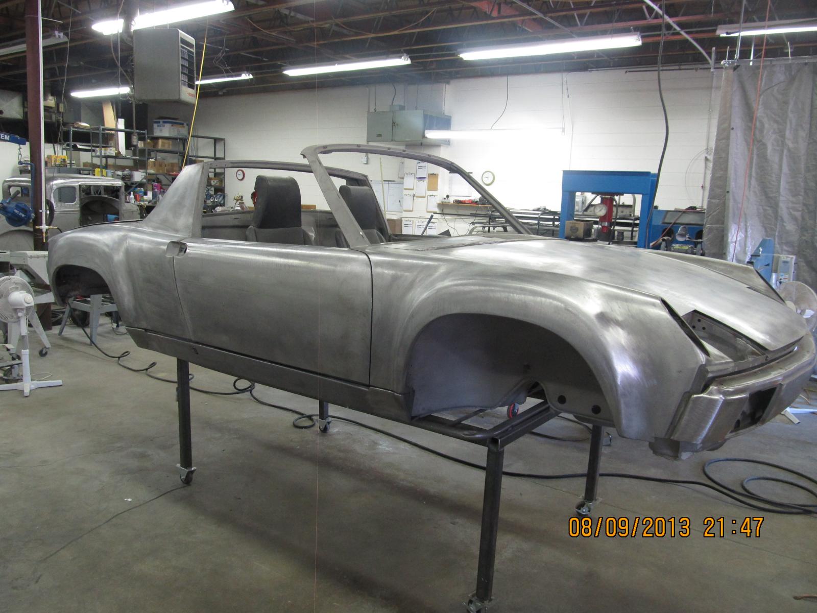

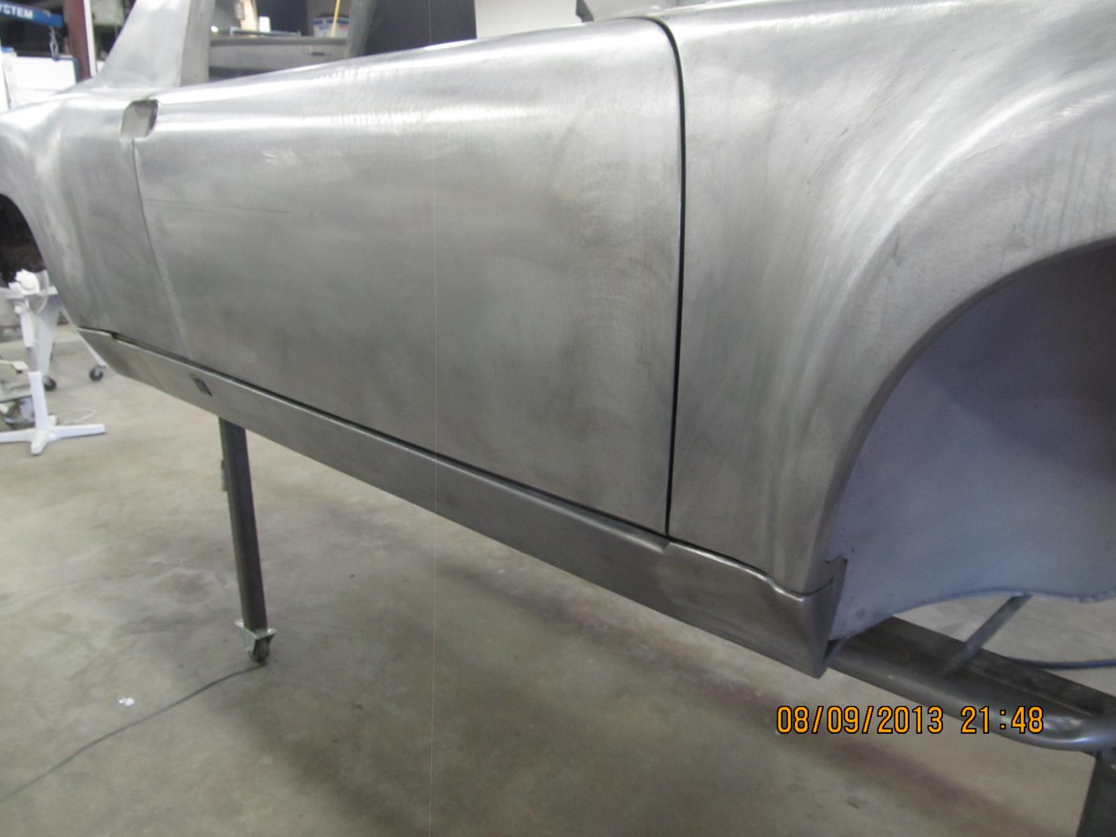

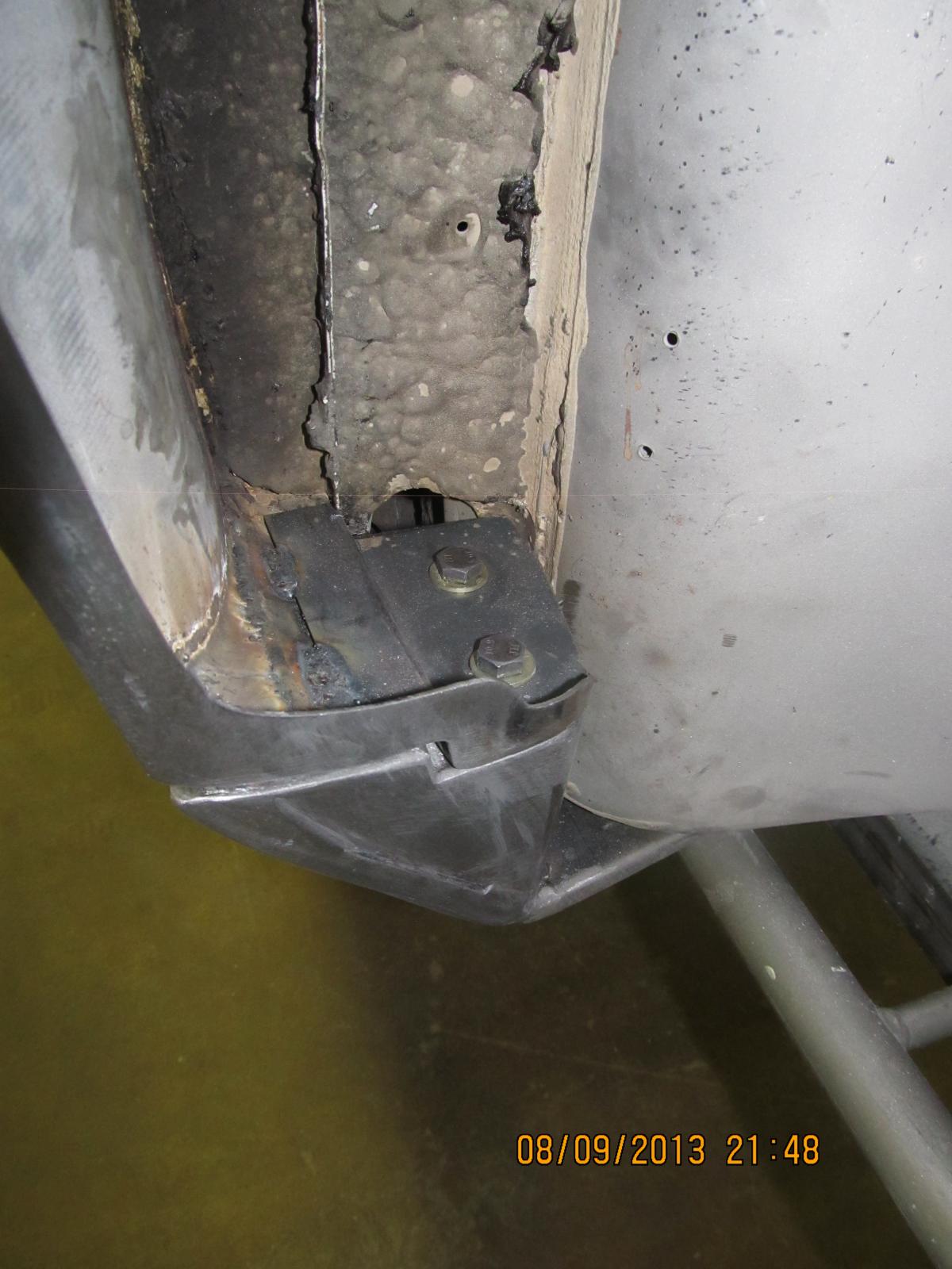

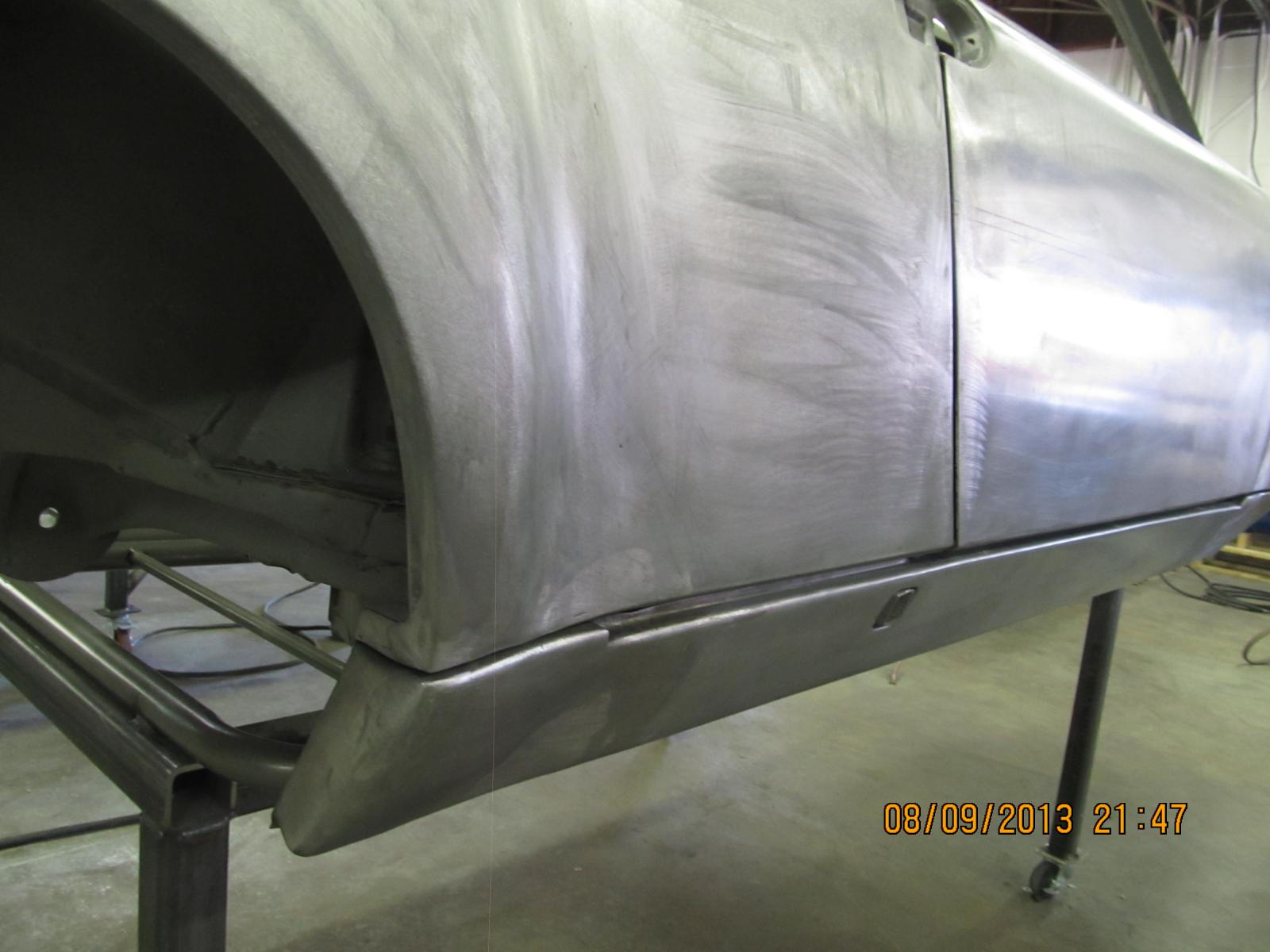

Work in progress continues.Finished right hand side rocker ends custom build including housing that bolts to the body front and rear.

The Metal Surgeon   Work in progress continues.Finished right hand sid...   Aug 11 2013, 03:15 PM
