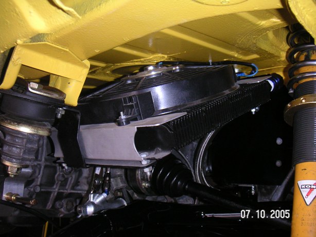

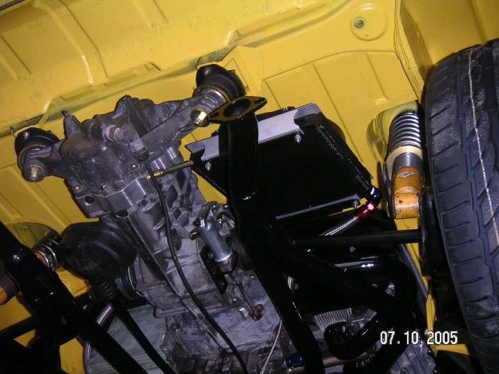

Does it have the under-body cooling flaps?
FYI, this is what Rich's cooler looks like:
